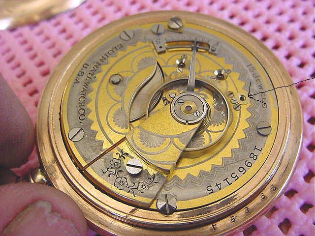

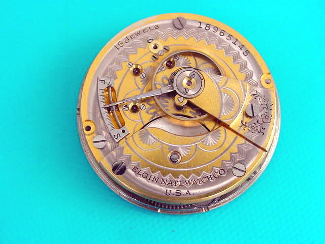

Here is a elgin that is on ebay i am thinking about biding on,looks like one of the jewels has been changed and was wondering if the hole has been made bigger to fit the jewel now in the plate..
what do you think could this be fixed. Smile

Nice two tone Elgin!! This is not an answer to your question but I see a screw missing (or broken) above the S on the regulator marker.

Robert missed the broke screw thanks for pointing it out ,,this is a common grade Elgin but i like the 2 tone dont see that very much on the Elgins.

Samie, I agree. The jewel for the palate fork arbor looks to have been changed to one that is not original. If you really like the watch and the price is right, I'm sure that, with your skills, you could put it back right. These jewels with settings are readily available. As you have stated, the only problem would be if the plate hole was enlarged to accept the new jewel.

Is it my eyes or does the movement look a bit small for the case (Note the gap on the left side of the pic ).. I really like the two-tone look tho

I believe that the jewel hole will be OK. The overlap of the jewel screws on the pallet jewel setting is about the same as on the other jewel settings. What makes it look odd is that the replacement setting wasn't relieved so that the jewel screws would lie flush with the plate. As a result, the screws stick up above the plate.
That sure is a nice example of TuTone damaskeening. Smile

Ed.and Tom do you think after the jewel setting is removed there wil be any damange to the gold flashing from the odd jewel now in the watch. Smile

Samie, As for damage, maybe or maybe no. I think it would depend on how tightly the screws were torqued in.

Since the plates already have the relief cut into them for the jewel screw heads, everything should be OK. It is the incorrect jewel setting that might be scarred by the screw heads. Since you are replacing the setting, it shouldn't matter.
