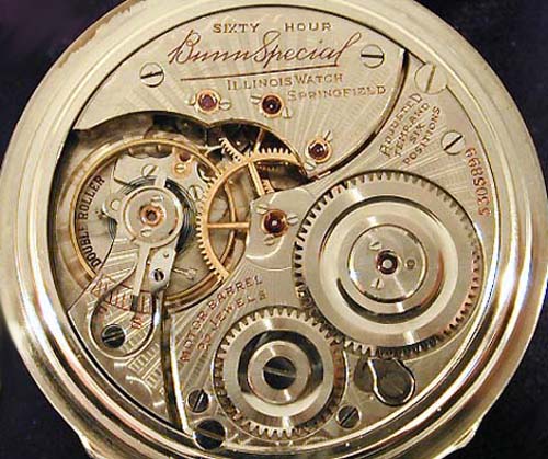

From what I can see the serial numbers for the final 23-Jewel Type III run is 5305001-5306000 and 5305899 is the one Don Herrington has up for sale! Does anyone have further information on this rascal?
Very clean looking movement 5305899 and more...June 05, 2005, 02:24
Mike CamelinYes, this is the last full run of type III's but of course the last ones were the first 100 block of the l63IR's range 5,321,001-100 and a few in the second 100 block as well. But this one is definitely near the end.
The thing that my eye picks up as "different" for this late a serial number is the fact that there are no pillar plate slot cut outs under the balance, I notice the double roller print is a little dark in the picture, so I hope it is red as well as if it is black something's not right. Maybe Don will humor us and pull the dial off of this one and confirm the pillar plate has a matching number to the one on the barrel bridge. If it does indeed match, this watch will be the latest one I have ever seen without those pillar plate cut out slots under the balance. Of course we know that Illinois was notorious for assembling at random and intermingling once there was a change over coming as is the case here where there was to be a change over to the "new" 163's shortly and of course a year later the Elinvars which was regarded as a "Hamilton improvement".
So Don, let us know if the pillar plate matches on this one and the Double Roller is engraved with red ink as is the rest of the engraving on the movement. This will help my research as I will record it in my notes and records, thanks, and Happy Huntin!

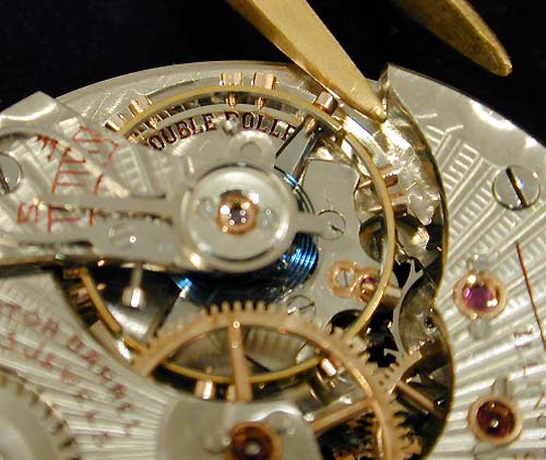

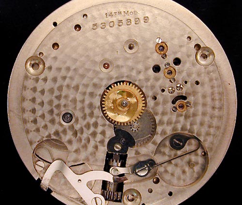

Don Herringtonhello fellas i have been off and on the computer lately so this is the reason for my tardiness.... check the time on my post and we will see how long it takes me to pull the dial and post a picture...... comin' up.....
June 05, 2005, 16:27
Don Herringtoncloser look under the balance wheel...red double roller...
15 minutes to locate the watch... pull the dial... untangle about 3 linear inches of micro fuzz from the 4th wheel post... reasemble...photo...and reply....
didn't think it would take me that long...

Mike CamelinThanks Don for the great post and pics, glad everything matchs up and I will record it for my records. You never know what will turn up, but of course you see my point that it is better to be safe than sorry. This watch that you sold is the EXCEPTION TO THE RULE at this late a serial number so again the only way to be sure one is not buying parts is to insist that numbers match.
It is obvious that they used an older style pillar plate on this one as they did not waste any inventory. It will be interesting to see if a correct 161 or 163 ever turns up without the channels. Great to see this one as the more we see the more we learn and as Fred A. Hansen (Sr.) says, "we just haven't seen it all yet,..."....and I might add we probably never will! Thanks to all and Happy "Numbers Matching" Hunting!
