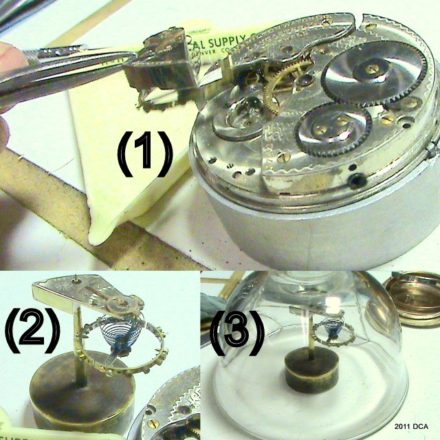

Andrew, After you unscrew the Balance cock screw;
(1) Lift the Balance cock enough so that you can also gently coax the Balance wheel to lift out with it.
(2) Use a Balance Tack to put them on.
(3) Then put them under glass to be ready for whatever comes next in their care.

WOW, I didn't think you could leave the balance dangle from the hair spring. Is it the same for a wrist watch.... smaller movement?
December 13, 2011, 23:49
Ray Hallenbeck
Its the same Andrew, should be okay as long as its covered like Dave shows. Otherwise, you run the risk of hitting and damaging it.

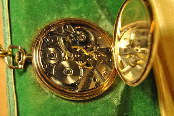

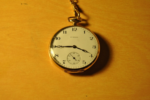

December 29, 2011, 16:14
Andrew Niscior
Finished and runs great.
December 29, 2011, 16:15
Andrew Niscior
Very nice face
