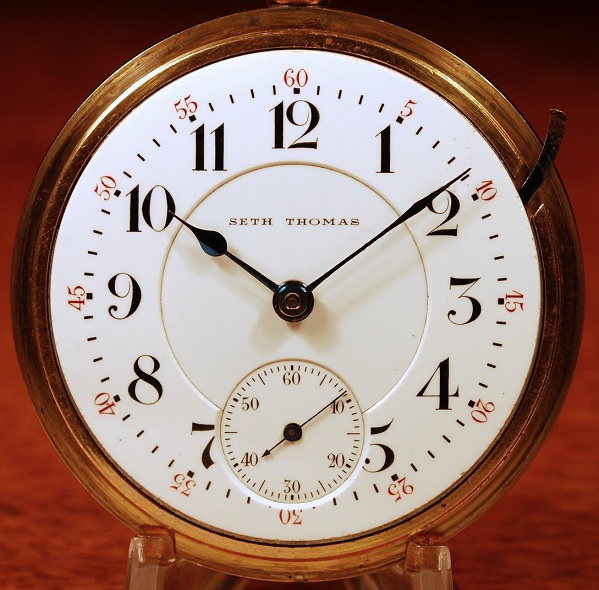

Interesting that the Ingersoll dial has the same font as one of my Seth DS dials.
