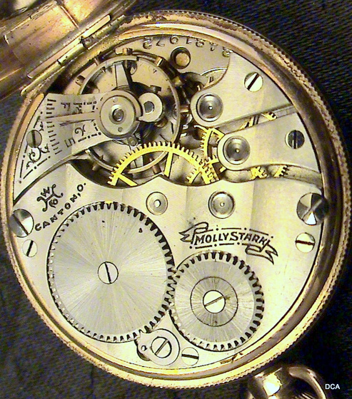

This is one of the Hampden Molly Starks which passed through my collection. As I recall the stem had to be removed after loosening the tiny screw in the neck. If your has no neck screw, then the movement should pop out when the stem is in the "set" position. It depends on the case as some were in wristwatch cases.
