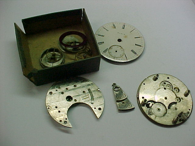

I FINALLY found a way around my "Taking a Watch apart" issue.
I can surely play with this one with no paranoia (sp) about taking it apart and killing it forever.
You just buy it ALREADY apart!!! Eek Big Grin Wink
She's an Elgin, 16s, 1928, grade 291, 7j, open face, model 7, Pendant set.
When I get it, someone will have to tell me what's missing.
I think I may use this one as my "Name that Part" piece. I need a reference for all the parts.

Elgin 32824027 16s 9950-1

I agree with you. Sheila, put that mess aside to use for parts. I would start with a working watch, that way, when you put it back together, you will know if you have done it right. If you start with a non-running watch, you won't know if what you've done, is correct.
