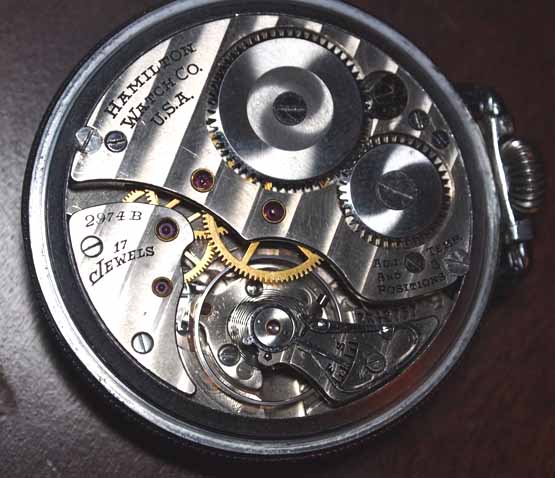

I nearly cried when my 1942 Hamilton 2974B hit the hardwood floor from a three-foot drop, in the vertical crown-up position, impacting at the 6-oclock position. No damage to casing, crystal or dial, but as you would guess, a broken balance staff.
Would a kind savvy please list the spec of this balance staff to enable ordering the correct one (e.g. pivot size 0.09, .10 or .11? etc) and maybe where I could find it.

And I'm sure this basic question has been asked before: Does the Hamilton 2974B have the same movement as the 974? If this is true, maybe the 435SR is what we are after.
May 15, 2013, 15:23
Gary E. Cochran
Paul,
I am not sure about the staff but the movement looks more like a 992b movement than a 974 movement..I would suggest you contact Larry Crutsinger at detent21@aol.com I am sure he could help you...Gary

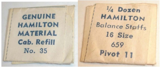

Look at David Abbe's post above in this topic wherein he pointed you to our Hamilton Parts List in PDF Format. The staff for your 2974B should the same as for a 992B upon which it is based. Hamilton number 607048 / 659 friction Fit to balance Hub, Pivot 11 for Grades 950B-992B shown on page 70 of the 1960 Parts Manual.
The reason I say this is because the 992B and all 16-size movements based upon it including the 2974B were completely new beginning in 1940 sharing no components with any previous models.
Confirming all this with Cas-Ker of Cincinnati, Ohio they still recognize it as 607048 which is the original part number (Their SKU: 22BB-58B and it sells for $25.00) and I am sure Larry Crutsinger would have the part as well, fortunately it is a common item, friction-fit therefore easy to service.
Hope this is helpful to you and others,
May 16, 2013, 04:38
Paul St. Pierre
Dear Lindell,
Thanks for your detailed reply which puts us all on the same page. Can you kindly confirm it this is what you are referring to:
