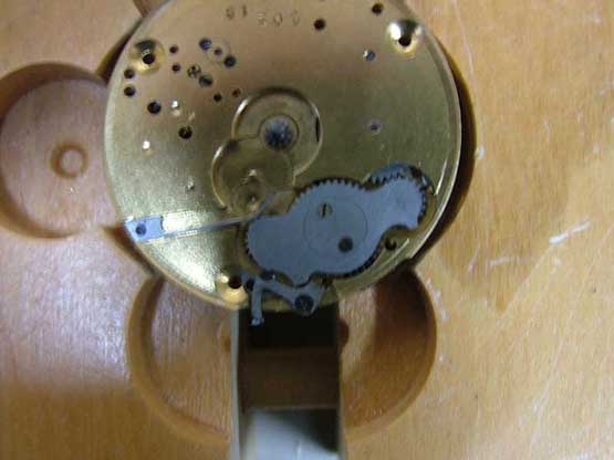

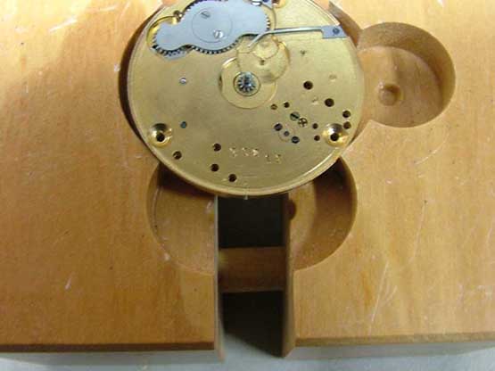

I have a Waltham hunter 6s movement that will not fit a standard 6s hunter case. The screw that hold the set lever extends beyond the plate and it also has a locator pin. Will this take a special case? Will this be hard to find? Any help would be appreciated. Thanks...Paul

Paul, unfortunately the answer to both of your questions is the same....YES....
The case you need to be looking for is an A.W.W.Co. case of the size 6....A lot of times Waltham movements are hard to find cases for, you just need to keep looking on eBay....one will show up eventually....
