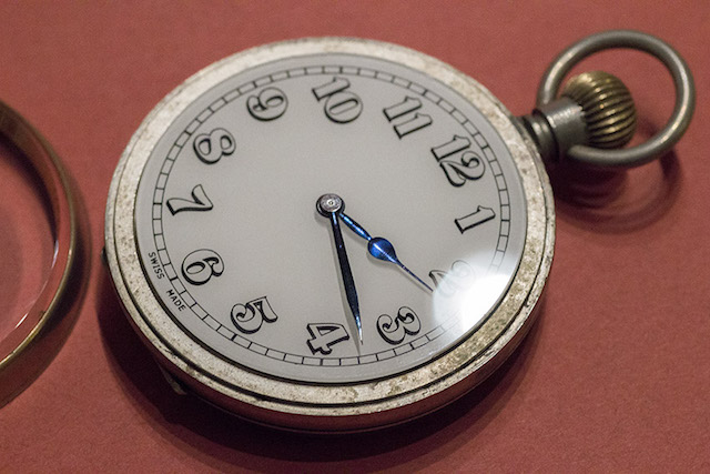

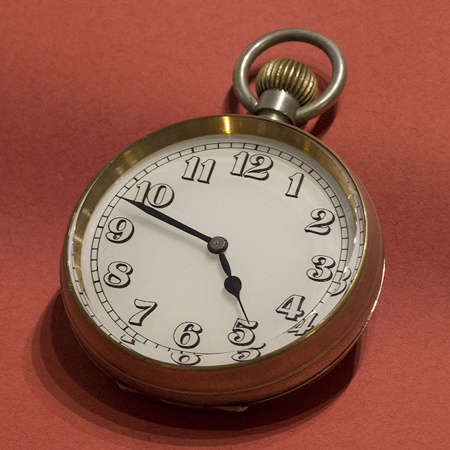

I've been working pretty hard on the project of creating new fired enamel dials for pocket watches and it's taking a lot longer that I initially gauged; if I was independently wealthy and didn't need to split my time between 3-4 different money-making activities then maybe I'd be a successful enamel dial maker by now. But steadily, I am proceeding to that end and I'm very happy with the progress I've been able to achieve. I have been working on the first and most important processes which are composition, imaging and printing. During the course of this discovery, I got the idea of photo-etching thin glass in reverse then loading the image areas with carbon pigment. I'm happy with the results and this is the glass dial I finished this evening. For the first time, I've made a dial that is for the most part, permanent and impervious to normal atmospheric degradation.
The diameter of the dial is 57mm and the glass thickness is 1mm.

Since the image is in reverse underneath, the top surface is flat and glossy!

It's a photographic process using a film positive and the image area treated with acid. The resulting etched areas are then filled with a black carbon pigment, then sealed with a white enamel paint which is kiln baked. This photo etching technique is something that will be utilized in the printing process but in the meantime I thought, hey, why not try this on a piece of glass? The positive used for this project was made here with an inkjet photo printer which was good enough for this large dial.
I probably won't make any glass dials to sell, I kind of did this just to see what would happen ....plus this old watch really needed a better dial!
This dial from start to finish probably took 3 hours.

Thanks William for details. Have you grounded edge on this dial, and if yes with what? How did you make a central hole, was it pre-drilled or done after? Im sorry for so many questions but Im really interested Smile
Rafal
November 16, 2016, 06:21
William D. White
Rafal,
The diameter was ground and the edges chamfered using crystal making equipment. The center hole was made using a diamond core drill.
