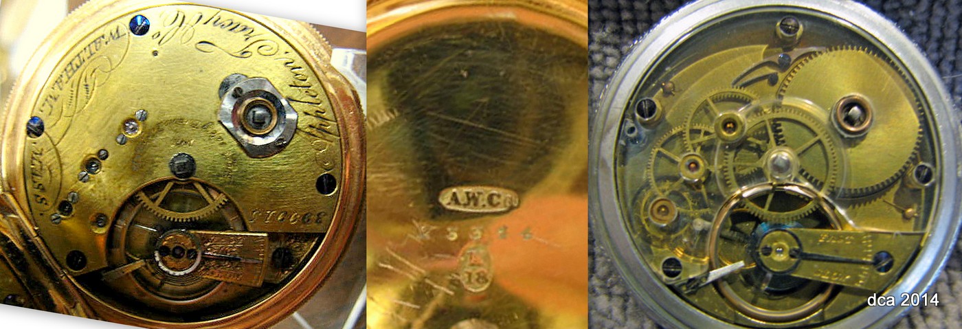

I agree with Paul as to the effort to fit a plastic top plate for the train. In comparing Rob's posted watch to a factory 18K cased version that passed through my collection, the issue becomes even clearer, as the plastic plate version has an un-jeweled pallet fork due to the severe limitation of drilling plastic with closely spaced holes.
Another thing of note is that this movement is a variant with a pinned dial (but a missing case screw) and the mainspring click spring located under the dial plate rather than assembled to the top plate, making this plastic conversion simpler.
