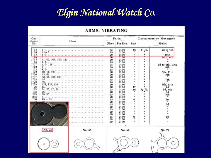

John, those are fairly standard Elgin under-dial parts for that era.

Thanks again for the education! Smile I've worked on a lot of 18s Elgin's but Fred's is the first I've seen with that style vibrating arm. The slide (courtesy of Wayne's site) appears to be the same arm. This brings up another question; has anyone seen a model 10 18s before? Could Fred's watch be a model 10?

Well, I got the movement in the mail toady. I've torn it down and it's an Elgin and most likely a prototype. Here are some comparison pictures to begin with. I will do a full slide show during restoration later. There are some missing parts for the setting mechanism but they appear to be the same as on the movement that went into Rich Kuhn's wristwatch. Go figure.... Roll Eyes Hey Rich, can I borrow a few parts from your wristwatch? Big Grin Big Grin
