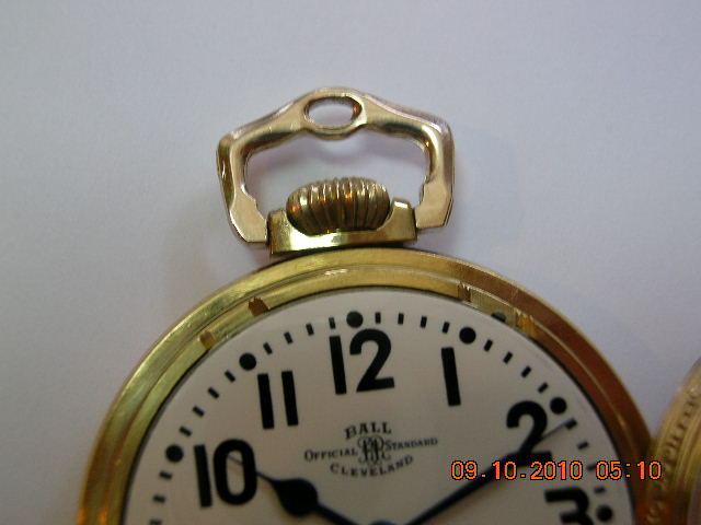

I just got this 999B that is supposed to be MINT.

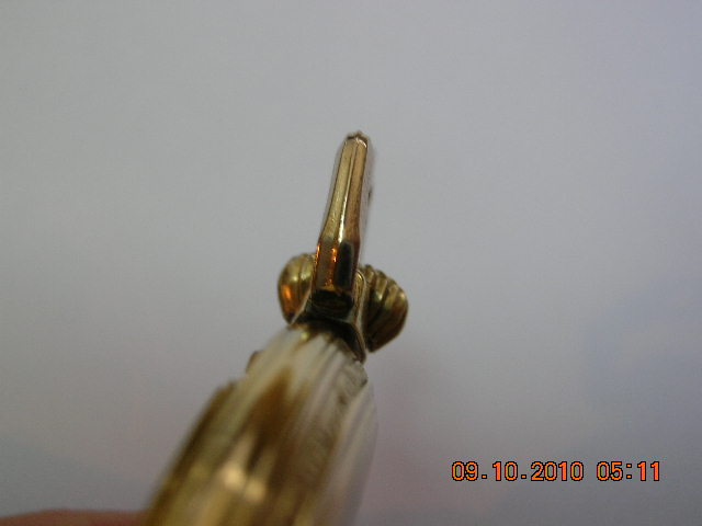

I hope i can get the pictures right. The bezel and bow and back cover are a rose color while the case frame and crown are a yellow color.
The bow also looks liks it was made with a DIE. I'm not a ball man, so I don't know, is that the way they make the bow?

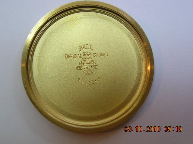

There are no numbers on the case frame at all, just the back cover.
The bow, I don't know if you can see the difference in the color.

Larry LamphierThe side of the bow, you can see the seam.

Larry LamphierAnother try at the color.
If you look at the crown and the bow you might see the difference.

Larry LamphierThe inside of the back cover seems to be more of the yellow color.

Robert V. JonesLawrence you need to look at this link
earlier linkSeptember 10, 2010, 17:31
Larry LamphierWow, that one is 8619198 and mine is 8619245, only 47 numbers apart. Or I should say only 47 FAKE numbers apart.
Thank you Rob.

Edward L. Parsons, Jr.Welcome to IHC185 Bill.  I concur with Larry and Rob that this is a restrike case, most likely with a cast replacement bow as well.
