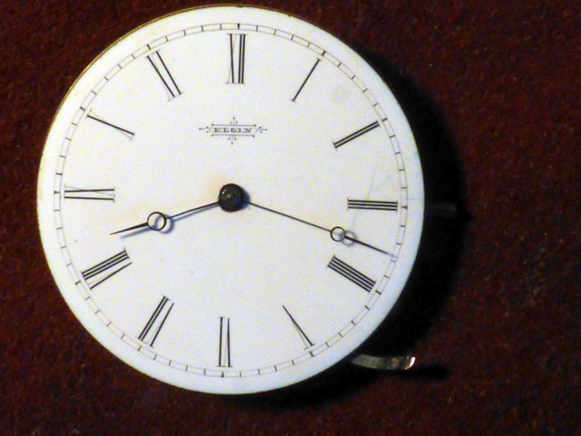

John,
Does the dial look like this, with no seconds bit?
If so, it is a hunter movement with a dial made with no seconds bit to use in an open face case.
(This one is for a hunter case, but they made both dials, hunter and open face, with no seconds bit.)
Clear as mud, right?? Confused
Steve

Steve,
Thanks for your response. The explanation was clear. I just hadn't seen any examples like mine. The dial is like the picture you supplied. Thanks again.
