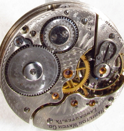

I have two old Hamilton size 16 stem wind and stem set movements that appear to need special winding stems. Model 972 s/n 62,776 and model 976 s/n 66,173. They are unlike any of my other movements even my other 972's and I have lever set and stem set models but not as old as these.
I took the plate off of the 972 to see how it operated and a piece of the old winding stem was still in there. So I have an idea of what the winding stem should look like, I think.
Does anyone have a photo of one of these winding stems they can share with me? Or better yet does anyone know here I can get a couple of these winding stems? If not I may be able to make on with my handy dandy new old lathe.

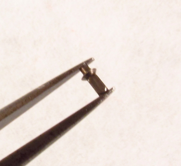

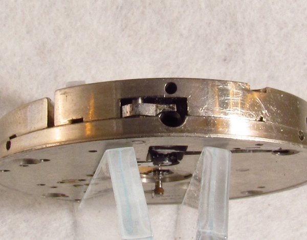

I have four photos coming up. The first on is a photo of the rear of the movement with the extra screw at the top that the newer models do not have. The next photo is of the top where the winding stem enters and works the lever that works the clutch. The last two photos are of what remains of the winding stem. The ring above the squared off end is what raises the lever that works the clutch. I suspect that there should be something similar above the lever to push the lever back down.

Top where winding stem enters

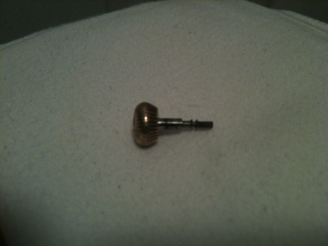

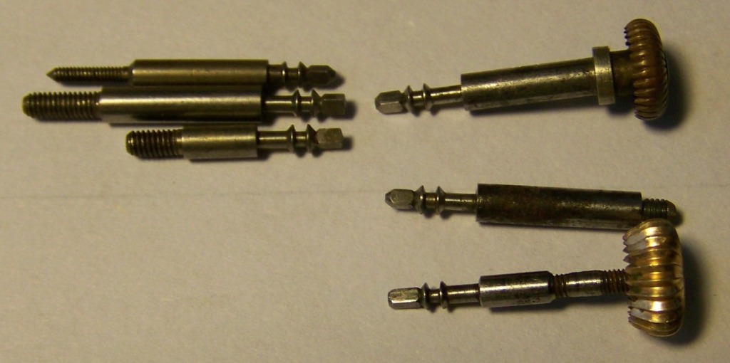

You will need a stem like this one. It fits inside the movement and you will need to adjust the stem screw (usually has an arrow next to it towards the top of the movement. Similar concept but not size to the 4992Bs stem.
January 28, 2012, 12:46
Harry J. Hyaduck Sr.
Thank you Dan. Well the bottom looks like I had imagined however the top does look like it goes into a conventional sleeve. Am I right? Do you have a picture of the sleeve that goes into? Thanks as always when you answer one question it always leads to another.
January 28, 2012, 13:06
Dan Carter
That is correct. The ones I have do not go into a sleeve. I have a 974 and 975 and in both cases (no pun intended) the stem is locked in by the watch and there is a small dust cap over the hole where the stem goes through to keep it from wiggling and that is it, no sleeve. The stem is locked in by the small screw at the top part of the movement. I ended up taking one apart and messing with that screw to see how it raised and lowered the setting lever. You can see how it would lock down on the stem and that the peg would fit into the small groove on the stem (yours looks like it is broken right at that point) and would allow you to pull on the stem and adjust the hands.
