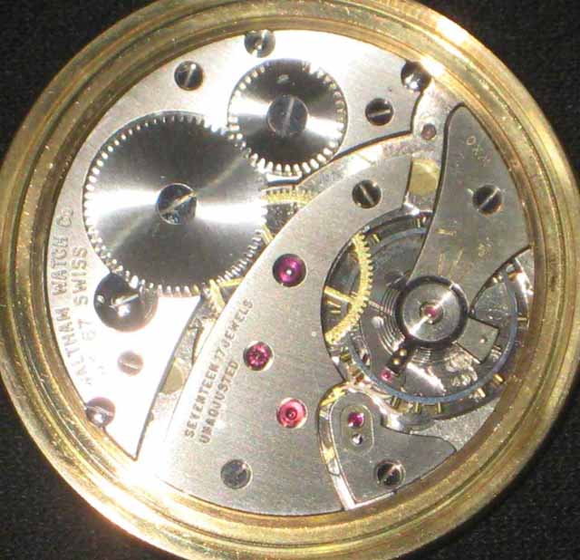

Late Swiss and Soviet movements are notorious for this. In the image below, the regulator needle is non-existant. What is the "proper way" of regulating this movement? With what, and how, to "grab" the regulator?

Some Chinese movements are the same. It looks like you would have to very carefully move the tab that holds the regulator pins. Probably with a pin or toothpick being careful not to insert it too far and contact the hairspring itself.

That is correct. I have a watch with this type of setup. Basically the guide that holds the hairspring (opposite of where the needle would be) actually becomes the needle. In this case slide it up to shorten the hairspring (speed up) and back to slow it down. IT IS A PAIN, but can be done. I worked on a coworkers watch like this as well and was able to get it timed pretty close but since you are so close to the point of rotation a small move can be big. At least with a needle you can make really minor movements.

Do you remember our discussion last week in this thread: How to safely stop balance wheel to sync the time in which you asked about on how to safely stop a balance wheel? We learned it is risky to stop a balance wheel. Adjusting this type of regulator is even riskier IMO, because of the amount of pressure required to move the regulator. The risk being in either case damage to the watch if control of the tool is lost.
Donald and Dan have described the only method I know of to adjust a regulator without a pointer, but it is for me a very risky proceedure due to the possibility of the tool you are pushing with slipping and striking the hairspring and/or balance wheel (or any other exposed part of the watch) and causing damage.
I do regulate my watches, and that is why I prefer watches with a micro regulator or at least a pointer. I have a watch or two with regulators with no pointers and I do minimal regulation adjustments or none at all on them due to the risk of the pushing tool slipping and damaging the watch.

Personally, I usually regulate these sitting in the Timegrapher. (The watch, not me. Big Grin ) That way, I can push the hairspring guide pins tab from the side rather than from above. That lessen the risk of damaging anything. Normally I use a dentists probe but you could use a tooth pick or a piece of peg wood. The tricky part is to see just how much (little) you move it. I recommend the use of a loupe.
