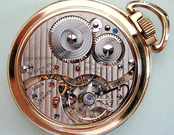

At another forum we started talking about gold center wheels on hamiltons how the later 992B made in the 1950's did not have one and the one's that did was not solid gold but gold plated.Now I was talking to some one I know and he said they were solid gold becouse it helped with the adjustment for temp.Now can any body tell me the truth solid gold or gold plated?And did it help with the adjustment for temp.

As a result of research done by several IHC185 members, the consensus seems to be that the "polished gold center wheel" that Hamilton used in early 992B's was brass, electroplated with 24K gold and polished, not solid gold.
The change to a plain brass center wheel happened somewhere between serial number C118000 and C119000, circa 1945-1946.

Mike SandellThanks Edward for the info I am learning here at this forum.The center wheels are made of brass
24 carrot gold plated and thanks again for that info from another post.

Gold plated center wheel and none gold center wheel
