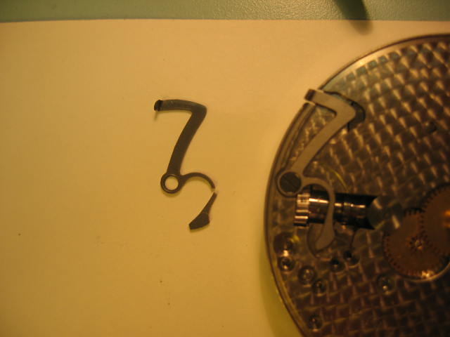

This all started with a Beautiful Waltham 645 I was restoring;
January 23, 2008, 00:21
David AbbeWhile testing the lever setting mechanism . . SNAPO went the TAIL on the lever!!
January 23, 2008, 00:24
David AbbeI find that these are scarce indeed, not available anywhere but in mentioning this to our own President Lindell Riddle, he tells me "We have all new ones with a STRONGER TAIL that are made from special tooling Chris Abell designed!" Mr. Riddle sends me a Chris Abell designed lever and "EUREKA!!!! The new one is more robust, fits perfectly, guarantees this watch another 100 years of productive life. Just LOOK at the difference in the TAILS!

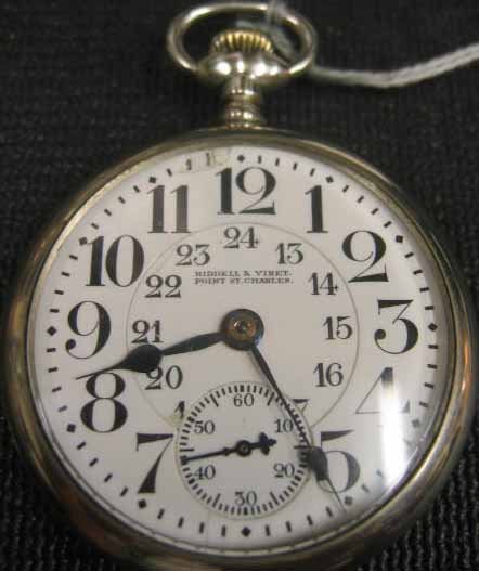

David AbbeSo as I am re-assembling the rest of my restored 645 24 hour dialed Canadian RR watch I notice something "familiar". . . .
January 23, 2008, 00:29
David AbbeThank you Lindell, for helping to bring back another "Riddell" . . .
