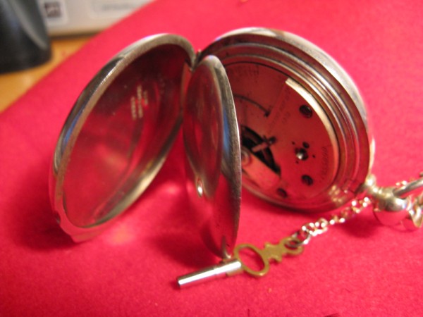

How do I set this watch ?
I have a Quaker City Watch and can not seem to find the way to open the dial to set the hands, it is a K/W K/S watch, but there appears no clip to allow the movement to open. Any help.

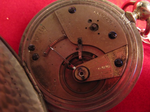

mvmt

Hi Bill interesting watch. So this case has no front openning? The movement is placed in from the back? I had a case like that, but was meant for early 18s late 1800's Elgins that were pendent set. You have a nice case, just have to figure out how to set the time.

It is not the hidden key case but it is attached the same way: a ring with the movement, the pendant and the dust cover lifts out of the front case.
Laying there for years they are ofte baked together by dust and dirt.

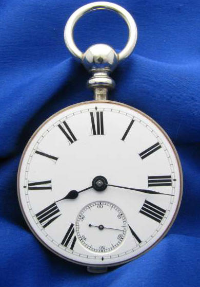

Gerald and Roland,
Thanks for the kind words and informatin. Upon reading the attached link, I found that if I held the stem assembly firmly and gave a pull the movement and dust cover came out of the external case. Interestingly I have had this watch for quite awhile now, and am sure I must have set it at some stage of my life. Anyhow have it figured out thanks to you folks, and as long as I do not forget, should be fine. Think I will write on my tag how to do it
