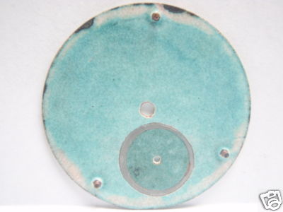

Jerry King
Rear of dial....
May 09, 2009, 18:23
Mitch Markovitz
It's an enamel one from what I've read, the Double Sunk Emergency Era during WWII. That's when they were having trouble with double sunk dials and went right to single sunk for a while. I've seen it on a number of 992Bs over the years.
It looks genuine to me account the glazing on the back, and the type on the face appear correct.

Jerry King
Thanks Mitchell, I was wondering about the production date of such faces but was concerned also about this one being only a single sunk model....

Jerry King
After checking here on the site:
992B dials
This dial would be approporiate on a 992B with a s/n of C137501 to C199800....and later....
