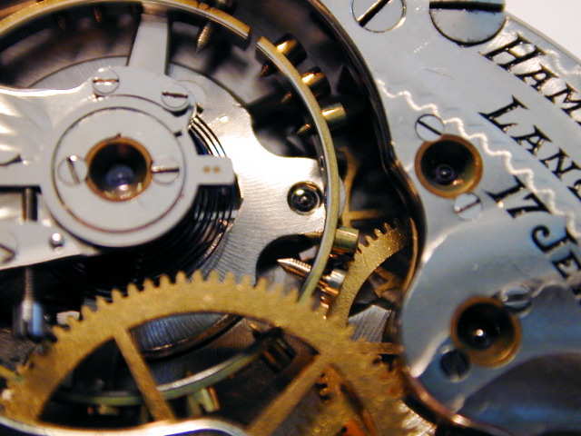

The following photo is of a 956 17j Hamilton. If you look at the pallet bridge you can see the ends of the pallet fork pivot protruding through the jewel. This is uncapped. Also take note of the escape wheel pivot. It is uncapped also.

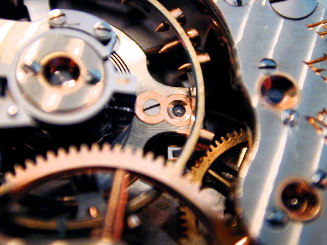

The second photo is the same shot but on a 992. Note you cannot see the ends of the pivots protruding through the jewels. These are capped on both the back plate and the dial side. This adds two pair of jewels thus making up the difference between 17 and 21 jewels.

Lindell V. RiddleEveryone, I believe there is some confusion as to what we are pointing to in the enclosed pictures. The pallet bridge is located directly under the balance wheel, and the jewel is in the very center of the picture. The first picture below is of a 17-jewel Hamilton 956 to compare with a 21-jewel 992 example in the second picture which follows.
At the focal point in the VERY CENTER OF THE PICTURE is the uncapped jewel in question...June 30, 2003, 01:40
Lindell V. Riddle Capped jewel is in the big gold setting in the CENTER OF THE PICTURE with screw to the left.June 30, 2003, 01:53
Lindell V. Riddle Look carefully at the pictures above. As Aaron stated of the the pallet fork pivot jewel is in the VERY CENTER of both pictures, and the escape wheel is in the RIGHT CENTER. In both instances on the 17-jewel they are uncapped, whereas on the 21-jewel version both are capped. Hope this helps to clarify the situation.

Stu GoldsteinIn the photos the pallet fork pivot end on the 992 appears to my aging and ignorant eyes to be just about as prominently visible as the one on the 956. If that’s so, the cap jewel must be transparent. If the cap jewel’s transparent, how can I tell it’s there?
June 30, 2003, 11:03
Lindell V. RiddleWhen I took the two pictures above it was to focus on the pallet fork jewel in the center of the picture. That's why that jewel in the
VERY CENTER OF THE PICTURE is in sharp focus.
There is
ONE cap jewel in the top (17-jewel) picture, the center of the balance. On the 21-jewel example
THREE are shown, the balance, pallet fork jewel and the escape wheel.
