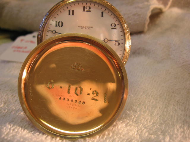

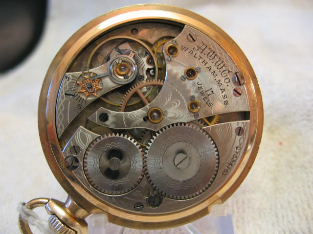

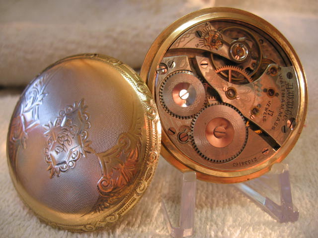

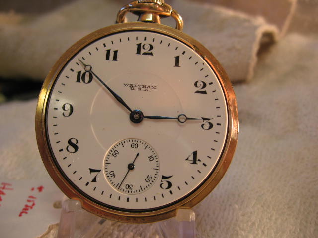

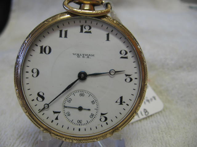

Jerry KingMy latest watch find is a Waltham U.S.A., 16s,17j, model 1908. S/N is 21334163....
Seems to keep pretty good time but it is a bear to wind....What causes that????
Anyway, here it is...:

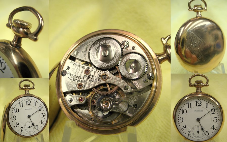

David AbbeWhen I put new mainsprings into the 1908 which always had a motor barrel (btw), they can wind harder for quite awhile until the main "relaxes" some, and then they get better. I have been running a Crescent Str. here for 3 months and it finally is winding pretty easy.
Sometimes (if you are lucky) it is a small indexing error where the winding stem is jamming. You can check that by loosening the case screws slightly and trying to manipulate the movement better in line to the stem. AlSO, the winding stem could use a lube. My Crescent (love those 99-08 movements made before the bean-counters);
