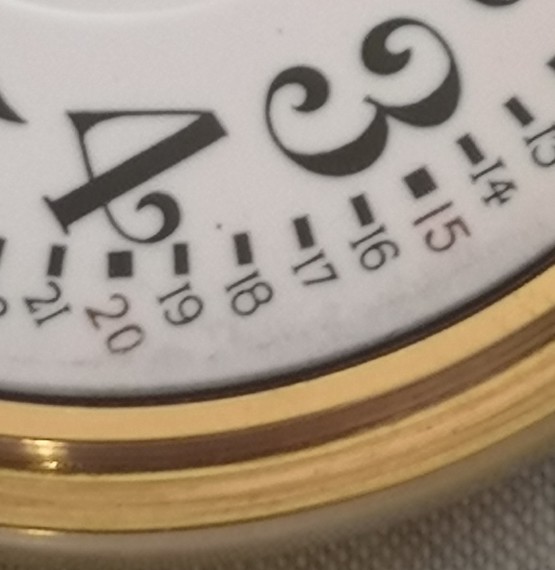

Jeff AinsworthWell I tried to remove a bezel rub extremely gentle with a pencil eraser which succeeded in removing 90% of the bezel rub however I inadvertably rubbed across the 0 of the 20 minute marker slightly removing some of the red from the 0 proving the red is vulnerable and not under the clear enamel hopefully can be seen in photo

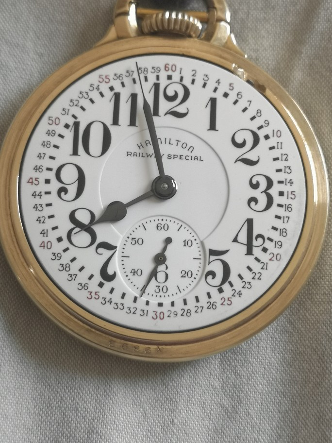

Buster BeckCould you show us the entire dial and perhaps a shot of the backside please ?
October 30, 2019, 02:42
Jeff AinsworthPicture of dial that has partially faint 0 in 20 marker didn't take out of case for pix of back of dial but is enamel soldered hamilton dial other dial to be cleaned is at another residence at the moment is enamel momntgomery earlier model though thanks for help

You are saying you attribute the "0" dulling as being from using an ordinary pencil eraser? If so, cold it be the pencil eraser was "dirtied" from previous use or perhaps the eraser was old and had hardened? Or is it possible the "bezel-rub" was so great it had gone through the clear glaze which is a protection for the numerals and markings?
Looking back at your original October 22 close-up of that "20" area I see an overall darkening and "roughness" from "14" through "21" on the marginal track is apparent. A soft pencil eraser would not do that but over the past 75-80 years or so (from the case and the dial signature your watch should be an early to mid-1940s 992B) the bezel may have. You might want to try "Rodoco" or a fresh pink eraser to go over that area, but first the dial should be taken off from the movement and then you can examine the dial under magnification to determine if that area is smooth or may have bezel-wear and therefore roughness that could be in play.
I routinely use an essentially UNUSED CONDITION very soft and very clean pink eraser in cleaning dial surfaces with no problems... but it MUST be very clean and soft to avoid any possible chafing or "roughing" of the dial surface.
A very soft, pink "block eraser" held flat can actually be of great help in "brightening" a Melamine dial, and for that matter minimizing of light bezel rub on nearly any dial. But the pink block eraser must be employed flat, with great care and understand it must be very soft and entirely clean. That "great care" part is most important in everything we do!
October 30, 2019, 12:18
Jeff AinsworthThe 0 had no problems whatsoever until after I removed bezel rub which was removed by 90% photo makes it look worst than it actually is, pencil rubber was white new soft rubber and bezel rub never extended over the 0
