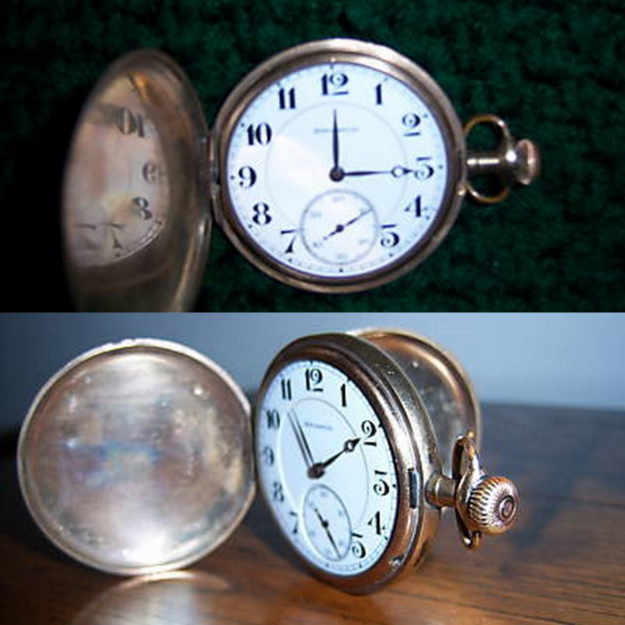

Nobody bids this but me Confused . . .

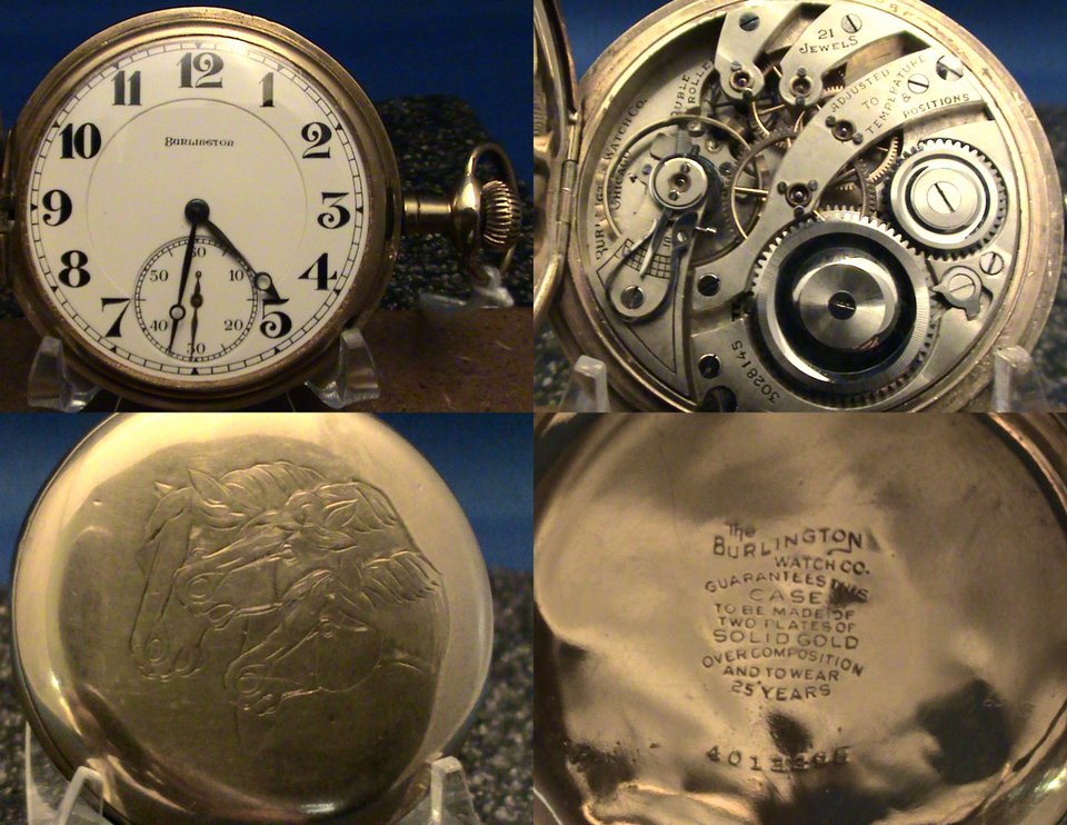

Sooo . . . for $51.00 plus a new; crystal, Balance (hair) spring, Main Spring, Bottom Pivot Jewel, minute hand, and 3 hours work, this triple signed perfect dialed 21 Jewel, Illinois Burlington Watch Co., in a Horse engraved Case is a "Silk Purse"! Cool Who woulda ever "thunk" this was a 16 size from the listing pictures!

Nice watch David.

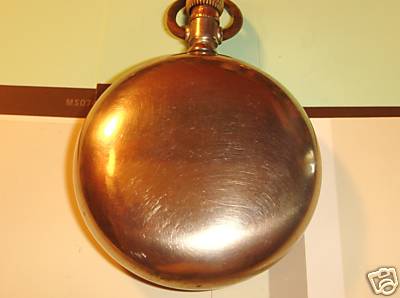

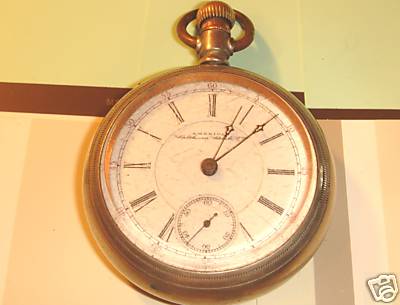

I've got a couple like the first example off ebay, trouble is I don't have the capability to make silk purses of them as you have....but I love to see someone do as you have done! Wink
The one in the pics below is in a Silveoid case and the crown is really brassed.
Keep up the great work.

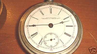

with bezel removed- 3 hairlines that I can find.
1 3min., 1 12min., 1 22min.

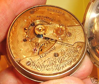

Jerry, That's an early RR Grade Waltham in a nice classy case! It causes me great puzzlement because the 5085268 serial number was for 15 jewel adjusted movements which this is NOT! If the balance wheel is reasonably good, and the numbers all match, it is eminently restorable, and the hands are probably worth what you paid for the watch! Also, question; Are the plates Silver or Gold color damaskeened?

The plates are golden and there is also something else interesting; notice, if you will, the first photo....through the crystal, there is a golden colored ring around the face of the watch. I have never seen this effect on any other of my watches and I also might add the crystal is very thick and beveled.

Jerry, You have a Gold-Plated Movement which is exceptionally collectible. Also the case trim is why I said before you have a very classy case.
