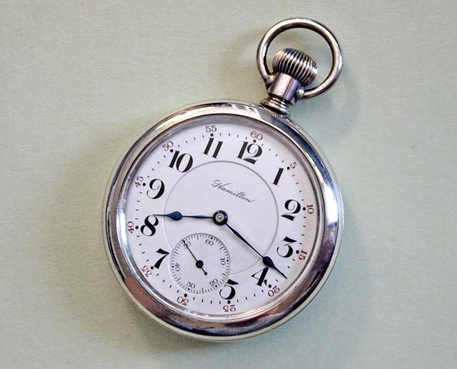

Hello Everyone,
I recently picked up a 990, what is the correct dial for these? Mine has a single sunk Roman numeral style, would an arabic numeral railroad style be correct? Also does this watch take a 3 or 4 foot dial.

Claude GriffithI have two 990's and one is a 4 foot and one is a 3 foot so without the serial number it is hard to say if you have a 3 or 4 foot. Also the serial number is a bit up in the air since during the change-over range they were mixed so at best you would need to check your current dial (or just count the hold down set screws on the side of the pillar plate). Both or my 990's are Arabic numbers since these were considered Hamiltons best 16s 21j RR watch I would expect most if not all to have double sunk dials with Arabic numbers.

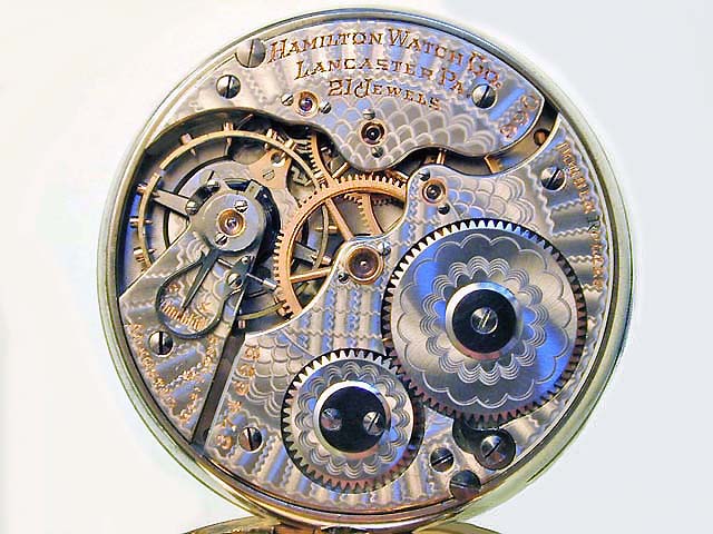

Edward L. Parsons, Jr.That 990 is indeed a handsome movement Lin. The juxtraposition of matte and polished zones in the design render a nearly two-toned overall effect.

Like most of you I strive to have my collection conform with contemporary advertising to the greatest extent possible. So, as to the "Double-Sunk Dial" question, my research reveals that every Hamilton Catalog and every Advertisement I can find dating from as early as 1905 and including 1909, 1910, 1915, 1918 through to the end of Grade 990 production in 1919 all contain the same basic language...
_________________________________________________________
No. 990 Open Face. Nickel, 3/4 Plate Movement, Lever Set Only. 21
Extra Fine Ruby Jewels in Gold Settings, Steel Escape Wheel, Double Roller
Escapement, Poised Fork and Sapphire Pallets, Micrometric Regulator,
Breguet Hairspring, Compensation Balance, Double Sunk Dial, Accurately
Adjusted to Temperature, Isochronism, and Five Positions.
The words "Double Sunk Dial" appear on every Grade Number 990 Advertisement that I have been able to find and they were apparently sold both as "movement-only" which would be cased and timed by the retail jeweler and factory cased as well. Based upon this information I think it fair to conclude that all but perhaps some very early examples were Double Roller and from at least 1905-on they came from the factory with "Double Sunk" Dials and the "Double Roller" Escapement. Whether some early watches had Single Sunk Dials, which I would seriously doubt and whether any of the earliest examples may have originally had Single Roller Escapement is open to further examination.

Gary E. FosterThanks to everyone for their input, I guess I need to look for a dial for my 990, any thoughts as to what would be a proper replacement. Also my watch is a double roller version.
June 06, 2011, 06:06
Claude GriffithOne like Lindell posted would be correct, maybe the very last 990's (1918-1919) might have had block Hamilton, off hand I can't say for sure since both of mine are earlier than that. Your sn is before Lindell's and I think your sn is after the cutoff for the 4 foot dials so you might find a correct dial on a parts 974 dial.
I went back and checked and I was correct about the later "block" Hamilton possibly being on the very last runs of the 990 but I wasn't sure about the very first runs and I guess technically the very early 1905-1906 runs might have had the Hamilton Watch Company style dials. I would expect any 990 from 1906 to 1917-18 to have the script type font that is on Lindell's watch.
