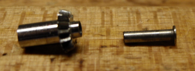

After I posted my last I realized I have a grade 77 BWR in parts, so I took a few photos of the winding & setting.
This 1st photo is of the stem, you notice it is two parts, when the stem from the watch case is inserted it pushed the small pin down which forces the watch into winding mode.
stem

This applies to most stem set pocket watch cases but not all.
The stem comes out from the inside of the case, so 1st the crown is unscrewed by holding onto the opposite end.
stem01

This is the three parts back together, you notice the sleeve is split at the end, this allows the beveled portion of the stem slide in & out of the sleeve from wind position to set position.
This photo would be with the crown pushed in & the watch in wind mode.
stem02
September 26, 2009, 01:55
Now when you pull the crown up to set the time, the stem clicks into the opening in the sleeve where the splits are, this is the click you feel when your pull the stem out.
Hope I helped some.
stem03
