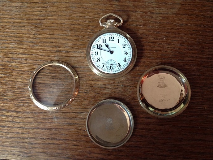

Here's the dial and case with what I think (hope) is a complete set of correct hands . . .
June 13, 2014, 16:58
Michael P. McNamee
And here's the back of the case:

Michael,
If it were mine I would go with the 1920s theory Lindell suggested, print this topic to retain with the watch and keep it in my collection. By the way, sometimes that dust cover is missing, you have the entire case.
And yes, those hands look right the way they should be.
Don

Thanks Don. The post is now printed, folded and put inside my watch folder. I'm curious to hear what others say about this. But my inclination is to follow your advice and keep this combination together, at least for now. But if I ever come across a mint-condition teens-era hinged South Bend case--like the kind shown in the 1914 catalog--I may be tempted to grab it. Smile
BTW, the movement screws line up perfectly, although it appears to me that a wider set of screws may have been used at one time, because the current screws don't entirely fill the marks on the movement. Could there be another reason for that?

When movements are taken in and out of a case, sometimes those areas will spread when the screw is re-tightened into place.
