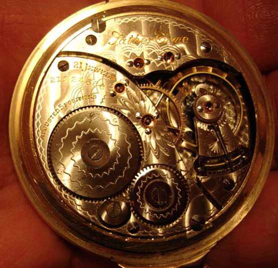

How about a picture or two, Stephen?
June 03, 2011, 16:58
Stephen John Ward
Okey dokey.......as soon as I get a chance.

Stephen John Ward
Here are some picture of the "Father Time".............
June 04, 2011, 00:45
Stephen John Ward
another one
Stephen John Ward
and another one..
June 04, 2011, 00:46
Stephen John Ward
last one......
June 04, 2011, 19:08
Roger Stephens
Very nice!!!
