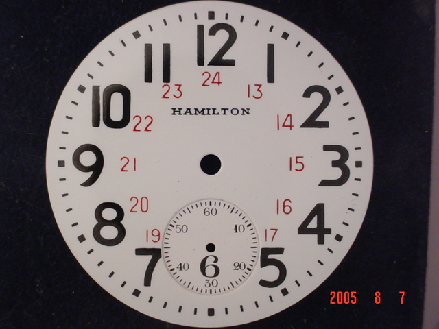

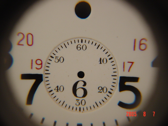

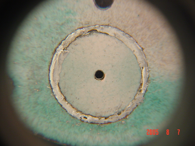

Charles R. SidesHere's the after pics. You'll have to take my word for how bad the original seconds bit was chipped. Think HUGE hole.
August 07, 2005, 23:46
Charles R. Sidesseconds bit
Charles R. Sidesback

Absolutely beautiful work Charlie.

Sheila GilbertFANTASTIC! Thank you for posting the Dial, it's really wonderful.
Congratulations!
