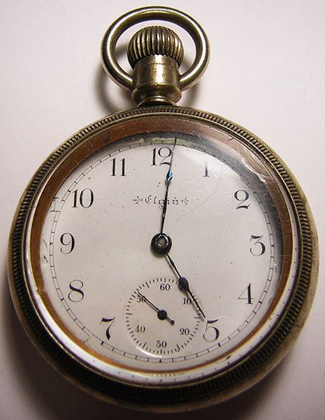

I just received this in the mail today and am a little stumped. At first, I was trying to take the back off to see what I had, but quickly noticed that it wasn't working. When I looked closer, I noticed that the back doesn't actually come off of the rest of the case. Here is the first shot of the watch.

When I realized the back couldn't come off, I took off the bezel with it's nice, thick crystal. Here's what that looked like.

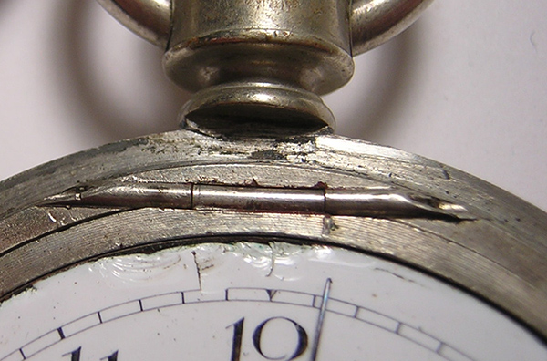

It looked to me like it was hinged and that I should be able to lift the movement up using the notch at the bottom and the hinge at the top. However, when I tried, this is all the higher I could get it lifted.
February 14, 2017, 12:15
Edward A. Huston
Am I wrong to assume that this is actually a hinge and the the whole movement should swing up? Is it something else that I'm missing? I hate the thought of forcing it up because with my luck I'll break it and ruin something.

Ed, that is a swing out case. All you have to do is to pull up on the crown as if you were going to set the time, and you can then swing the movement up and out of the case. You will then be able to see the case screws on the ring that will hold the movement in place. It was supposed to be more of a dust proof case as it didn't have a back bezel.
Be sure to always pull that crown up before you try to swing the movement up, as you can break the stem if you don't. They are a good case, but many don't like them because they don't know how to adjust them so they work properly. If that stem is not adjusted properly it can still catch when you are trying to swing the movement out, OR if it is adjusted wrong the other way and you pull the crown up to set the time it will not work. Real easy once you learn how to do it.
Also, always leave the crown up while swinging the movement back into the case and if you feel it catching, just turn the crown a little and the stem will seat in the movement and go in nice and smooth. Then just push the crown back in and your good to go! Smile

And right you are Larry!
Popped right up. It doesn't appear to be anything unusual as far as my only partially educated eye can see. Looks like a whole bunch of them were made back in 1899. I do like the pattern on the movement though.

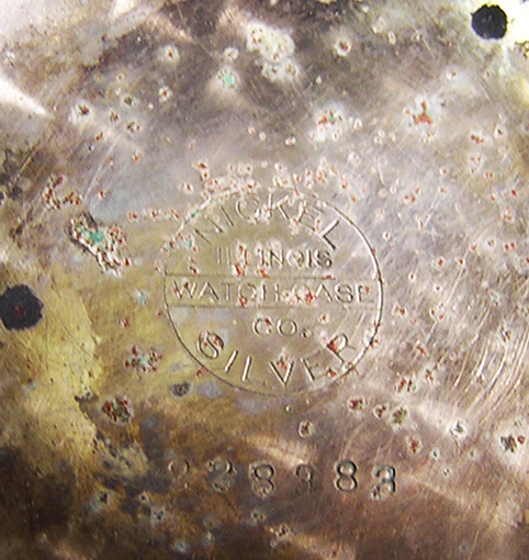

I do have a couple of questions about the case though. It is an Illinois case, but it says that it contains both nickel and silver. How usual is that? And how often were these types of cases used? Again, just a couple of things that are new to me.

The nickel silver wording means it is nickel made to look like silver. Many other case makers made imitation silver cases with names such as Silverode, Silveroid, Silverine, etc. They are base metal cases that were made to look like the silver cases that were made for earlier watches. They are attractive cases that don't wear out as easily as the gold filled ones. They were also pretty common because they cost less.
The swing out design was also fairly common. My 1910 Hamilton 940 is in a swing out "Nickel Silver" case made by the Illinois Watch Case Company and my 1925 Waltham Crescent Street is in a yellow gold filled "Elgin Giant" swing out also made by the Illinois Watch Case Company. In fact, the "Nickel Silver" case looks exactly like yours. It has an inner ring under the crystal that is brass. It looks like yours has that too. It also looks like your case serial number of 238983 shows that the case is older than mine that has the number 0099793. Your winding crown is in much better shape though. Mine is pretty worn down.
