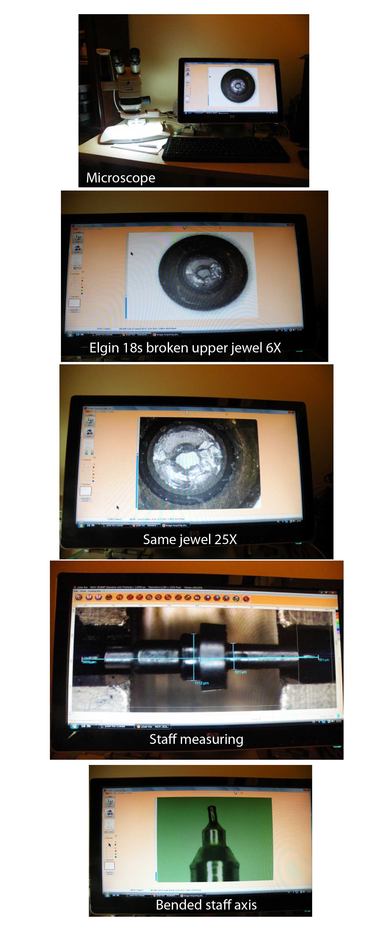

I am very new in the world of pocket watches. Just 21 months. For me the most difficult things are staffs, jewels and hairspring. Since 3 months I have a new assistant. With his help, determining, measuring and replacing a staff or balance and plate jewel are no more problem. Actually I have 2 more problems: hairsprings and roller plate jewels.I need some more time.
Please take a look to my assistant. His name is Mitutoyo 377-975. The program is Pixel Fox.

Oooooh -Ahhhhhh! A stereoscope hooked up to a computer! Sweet! That's what I call getting up close and personal, Bulent!

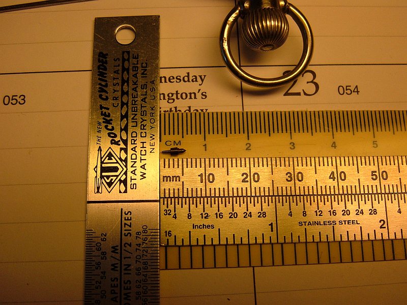

Here's a poor example. I'm trying to measure a staff. Yes, I have calipers but find it very difficult to hold the part and get a measurement.

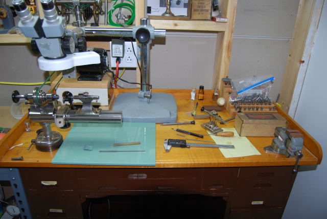

Roger J. Nolfe
Dave,
You can get measurements easily by putting your staff in a pin vise. I usually put one end in rodico and then pick it up with the pin vise. Then flip it around for the other measurements. For length, I lay it down on the rodico and push it in a little so it doesn't move around.
I admire the oldtimers who were able to make these parts in short order with little or no magnification not the best of lighting, and gravers that were scalpel sharp.
It takes me hours under a microscope with great light to turn out a nice piece. I paid around $200 for my used microscope and it is one of the best investments I ever made. The picture shows the microscope over my one of my Boley lathes.

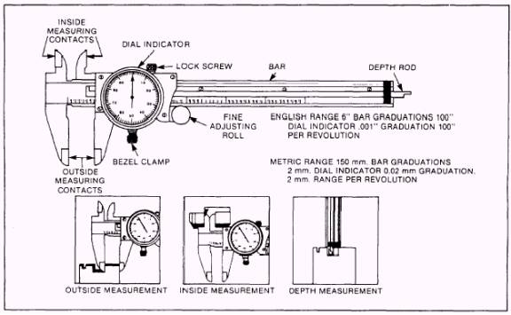

Joseph Boone

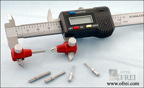

Dave you could also go this route. It helps when using the caliper.

Roger J. Nolfe
Bruce,
My microscope is an American Optical Cycloptic Stereoscopic model. I am no expert on microscopes and was lucky to find this at a mart where the owner demonstrated for me how it functioned. This is a very old scope, but I think ideal for watchwork. It has a dial to change magnifications with different internal lenses. The eyepieces are 15X. The important things to look for IMO are the working distance, which is 4" on mine...that allows 4 inches between the lens and your workpiece so you have plenty of room to work under the lens, and the field of view, which can be very small...like 1/2" or less. Comparison of size of detail to the magnification range is important. In other words if you want to work on a balance staff pivot you need to be able to focus the scope to that size. One other thing is the quality of the optics. Today there is so much junk out there you have to be careful. Hope this helps you in your quest for a scope.

A good vernier is most important to us when working with staffs and "practice makes perfect" to make measurements.
A dial vernier scaled in (.001) inches of reasonable quality is far easier to use (for me) than ANY of the digit reading types for several reasons;
1. The Staff ends are usually tapered and I need to know the maximum "fit" measurement taken at the terminus between that diameter and the larger diameter next to it (such as the "shoulder").
2. When measuring new staffs to make sure they are correct, I use the vernier as a "comparator" meaning that I note the same dimensions in the same places of both staffs to confirm their "sameness". The actual numbers mean little the "same" numbers mean everything to a successful replacement. To that end a dial vernier seems (to me) to be much easier.
3. Dial verniers work all the time, "batteries not included".

Roger J. Nolfe
Evan,

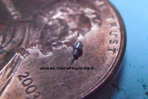

My scope and lathe is on a watchmakers bench and is the perfect height for me...I'm pretty short at about 5' 5.5". The picture shows a recently made part that I'll tell more about in the near future.
Bruce...You may want to consider Samie's scope. It would be a real bargain. One thing I didn't mention earlier is the weight of the base. As Samie points out they weigh a ton. It is important that it be heavy so there is no movement of the scope while you are working. Shipping might be a problem because of the weight.

Do you work on the lathe standing up? If so I'd agree that the higher bench could work well.

Roger J. Nolfe
Yes Evan, I stand at the lathe while working.
