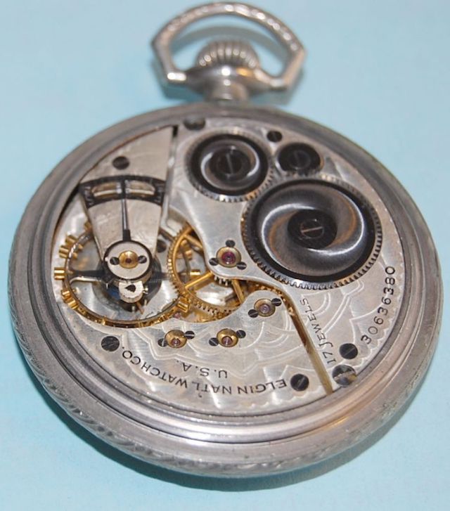

Elgin 387 17J - Needs a staff
A friend dropped this watch off. But I've found a broken balance staff. I'm not equipped to repair this and wondering what the cost might be these days so I can tell him what it might be.
Very nice looking, wants to run face down, and probably worth repair.
Need some estimate so I can tell him what to expect.
Also wondering how old it might be. The Elgin database lists these from 1910 - 1945. I suspect it close to the end of the run?
Dave

January 17, 2019, 17:38
Roger J. Nolfe
Dave,
The cost depends on who is doing it and whether it is going to be done right or not. The question seems simple enough...just replace the staff. Well there is more to it than that and I'll explain how I would do it. First I need to know the pivot size of the staff I need. The same staff part number can have several different pivot diameters. Now spend some time finding the right replacement staff. I need to remove the balance cock from the movement and tear down the movement so I have just the plates. Check balance jewels for any damage, clean, oil and replace them. Take my new staff and fit it to the movement by itself. Check for endshake, sideshake and overall fit. After removing the hairspring and roller table, taking note of which side of the balance the roller jewel was and the general position of the hairspring, cut the hub off the old staff on the lathe. Check the roller jewel to make sure it isn't the least bit loose and re-shellac as necessary. Rivet the balance to the new staff and put the roller table on making sure it isn't going to split in the process. Poise the balance so the watch will run well in positions. Put the balance with roller table in plate and replace the balance cock. Check for nice free spinning and truth of balance wheel in all positions and recheck endshake and sideshake. Remove the balance and install the hairspring. Put this assembly back on the plate and check to see that the roller jewel is exactly between the banking pins at rest for the initial beat adjustment. Set the balance in motion and see that the balance oscillates for at least a full minute and comes to rest in a smooth, not jerky manner. Now you can remove the balance assembly and place it on a balance tack, cover it and work on the rest of the movement. BTW, to be honest, I would have already cleaned the plates and examined the rest of the parts before starting on the staff replacement.
Because there are so many "gotcha's" it's hard to place a set number on the job but just to give you a rough idea, figure about $50 for the staff replacement portion of the service.
Roger
January 17, 2019, 18:46
Dave Turner
Thanks Roger, Appreciate the detail. I'm sure this watch needs all of that.
But, as you know a majority of these old watches aren't worth the cost of a proper repair.
And again, it's not my watch, so that's the owners decision. I think it was his Father's, and he may not care what the cost is.
Just my take on it. FWIW
I'll pass this information on. You might get the job!
