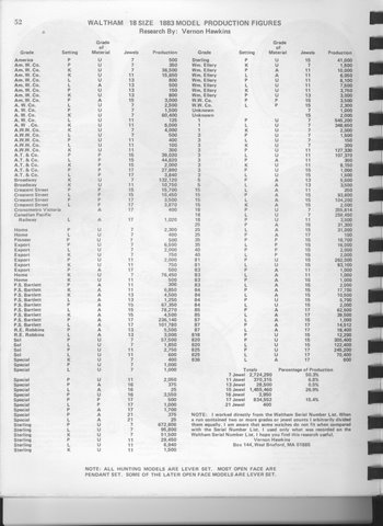

This is a Waltham model 1883 production quantity report that might be useful. With no pictures helping on the watch is harder. It probably should have a Gold Filled C.W.W.C.Co case, and it MUST have a 24 Hour Dial, usually all arabic

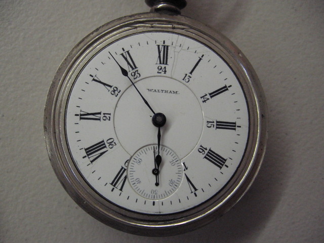

The 24 Hr dial on my CPR

I was just looking at Larry Buchan's story about a trip on the canadian railways and found this pic.
Other than the name it is a match for the one I am talking about.

I finally had the opportunity to view this watch again. The dial has some hairlines as you can see. The case is a AWCco. sterling swing out with two not so very nice dings on the side. Would anyone know if the case is repairable?
The mvt is OK with some minute scratches.
The crystal has many small scratches which makes the dial appear clowdy.
Excuse the pics, I was in an awkard position with many people around.

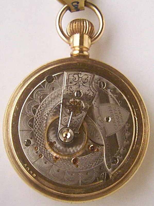

Edward Kitner
Mvt.

ED WATCH OUT!! THIS IS NOT A CPR WATCH. THE BARREL COVER DAMASKEENING IS NOT THE SAME PATTERN AS THE MOVEMENT PLATE BECAUSE IT WAS NOT MADE FOR THIS MOVEMENT. THE WALTHAM PRODUCTION NUMBER SERIAL SERIES HAS NO MENTION OF A CPR WATCH EITHER. IN THE 12,003 XXX THERE WERE
APPLETON TRACY LEVER SET 17J 12002301 - 3500
APPLETON TRACY PEND. SET 17J 12003500 - 4000
WITH A MIS-MATCHING DAMASKEENED BARREL COVER ON A PLAIN 17 JEWEL APPLETON TRACY & CO. PENDANT SETTING MOVEMENT. IT IS A "FRANKENWATCH"!
IT HAS LITTLE OR NO VALUE EXCEPTING THE CPR BARREL COVER IF THE REST OF THE ORIGINAL MOVEMENT COULD EVER BE FOUND.
OFFER THEM $50.00 IF YOU WANT A FRANKENWATCH.
I may be wrong but it's my understanding that the barrel covers were always a different pattern on these watches the numbers should match though.
George.
April 14, 2008, 22:54
George, Your point certainly has merit for the cause of the "Beaver" etching having to be on the Barrel cover, but there are two other disqualifications for this item;
First the serial number set of this movement in question is for an Appleton Tracy Pendant Set watch. ALL 1020 Waltham CPR movements made on the Model 1883 platform are Lever Setting. (Ed Kitner's dial picture above rings this alarm quite plainly. There is no lever.)

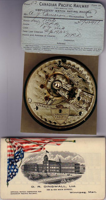

Larry Buchan
here is some documentation about whether CPR watches had to be lever set, the watch card from 1902 clearly shows that pendant set watches were approved at that time
PAGE 53 CANADIAN PACIFIC RAILWAY FORM 94
TIME SERVICE DEPT.
EMPLOYEES WATCH RATING RECORD
Mr. AJ Cameron Occupation C. (Conductor)
Maker of Movt. Walt. No. 5742981
Grade CPR
Case O.F Nick
Date lost Cleaned September 19, 1902
Name and Address of Cleaner D.R.D. (in script)
D.R DINGWALL LTD. Inspector

Larry Buchan
here is the dial off of my pendant set Waltham 1883 CPR
April 16, 2008, 17:09
That is a beauty. Your marked s/n5742981 is listed in Waltham factory records as a 15 Jewel model 83 Pendant set Open Faced Grade 35 Premuim Grade movement, meaning it would at the time of manufacture be OK for RR use, although there is no mention of CPR in that 1,000 Pc series.
I have no doubt that yours is correct, even including the 17 Jewel vis-a-vis the 15 Jewels logged by the watch Co. I also notice your watch has matching damaskeening all the way around including the Barrel cover.
Your watch by not being mentioned as CPR in the Waltham records actually predates by 6 years (1891 vs 1897) the earliest production CPR recorded by the compendia of factory described model 83 listings which also do not mention any pendant setting CPR models at all. You certainly have a rare duck!

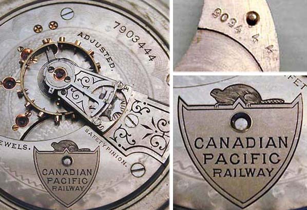

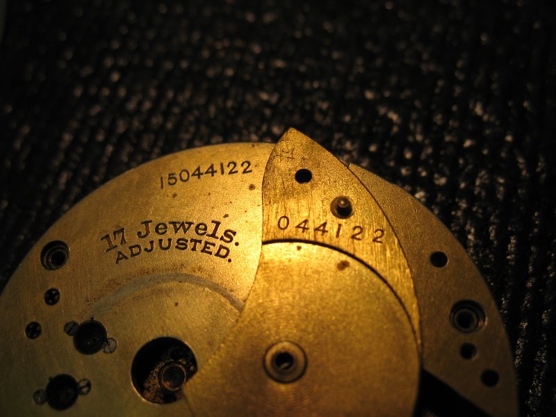

Ed, CPR RR grades are just one of Larry's passions and fortunately we have his knowledge to help with these things such as the earlier Pendant setting model he has. With respect and deference to Larry's point, the Barrel plate Serial number should be verified to the movement serial number to confirm what this watch really is. The picture below is an example of what kind of number may be somewhere under the Barrel cover that should match the movement serial number. It may not be in that exact location, but there must be a full or partial matching number for the watch to be "as claimed".

Here is one I sold in October of 2005 in our IHC Auctions...
CLICK FOR: WALTHAM CANADIAN PACIFIC RAILWAY, MATCHING PLATE NUMBERS!
Pendant-Set, the damaskeening differs but the numbers match.
Numbers matching on this Canadian Pacific Railway...
