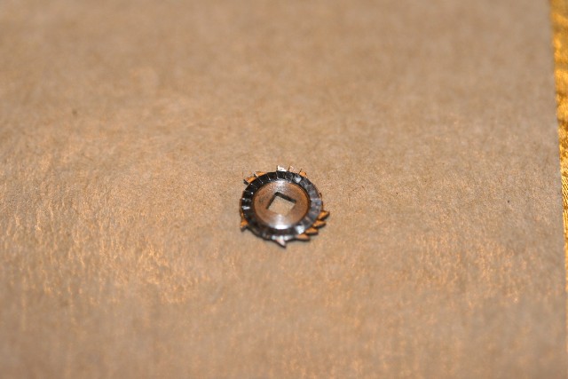

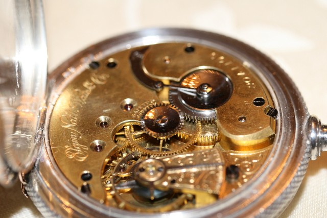

Bob Kerr
That was the bad ratchet

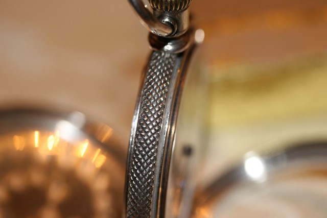

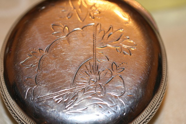

Bob Kerr
Nice coin case
fan on back, little different
August 07, 2007, 21:58
Bob Kerr
Coined edge

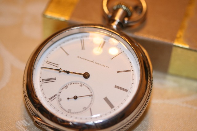

Bob Kerr
Dial pic
Dial is close to perfect

Your watch is beautiful, and your pictures look great, lots of detail, and so clean!
Don't ya just love to see that shine?
I just love to see a watch in need get a new life.
Thank you for sharing it.
PS I don't know what ate up those teeth, but it sure did a job on it huh?

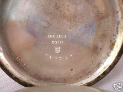

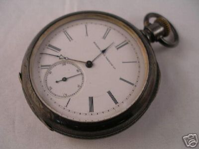

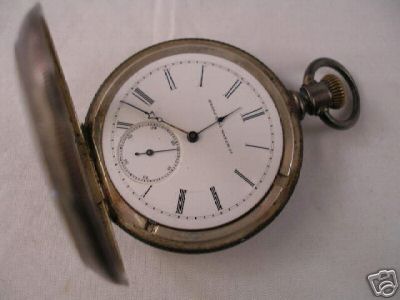

August 08, 2007, 08:20
Bob Kerr
When I recieved it the crystal was broken

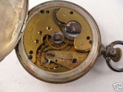

Bob Kerr
And before going into the ultrasonic tank

This makes it even better, I always am looking for Dueber Hampden pw's. With a little work this 121 yr old guy came out pretty good. I did notice that the camera picked up some "fuzz" left over from the case cleaning (q-tip). That was taken care of now. This job is done and put back for others to enjoy.
I get the biggest kick out of bringing these back to life.

Oh my goodness! what a difference!
Sometimes it takes pictures like these to show just how much they change with some tender loving care.
I also forgot to mention that, that is one really nice coin case, and I do like that coined edge. I had not paid much attention to them before, but since I have been looking at them more often, the coined edge seems to pop out at me when I take the time to really look at them. I like it a lot.
Congtatulations on a wonderful repair and such a nice watch.
