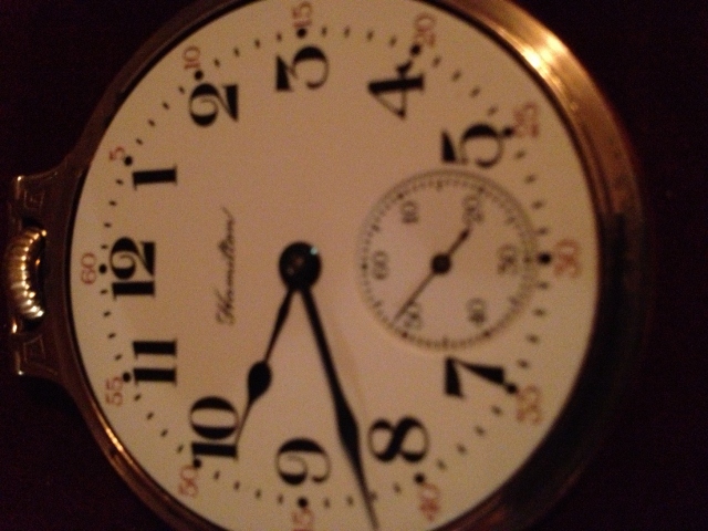

Can I please get some advise as to what movements and cases go with these dials First image is a 974 movement, s/n 1189405, 16s 17j. The second image has a 992B movement, s/n C40114--I am currently looking for a dial for it: and I have this Model 2 Wadsworth Quality 10 Karat case, s/n 0440079, PAT 5-22-26. Is this a good case for the 992B movement? Thanks, Mike

another dial-script lettering, what would be an appropriate movement for this dial? Would this be an OK dial on the 974?
script dial

Hi Mike,
This might help you a little.
Case and Dial info
Let me add that the Script dial in the Wadsworth case is to early for that case. I can't tell the year without looking at the serial number of the case, but if you study that link, you will see where Richard has explained that same thing to someone else on the script dial. That is VERY helpful information there.

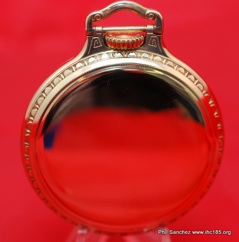

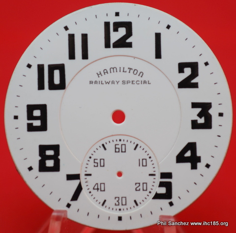

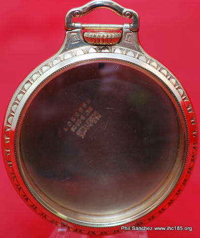

Phillip Sanchez
Mike, Hi, I have a perfect model 2 case # H66503 and a perfect # 536 RWS porcelain dial if you are interested, however before you contact me ascertain if you really want to put that much money into your 992b. Neither of these items are inexpensive.
philsanchez2020@gmail.com
I also have a perfect script dial if you are interested
May 12, 2013, 11:19
Phillip Sanchez
back
May 12, 2013, 11:19
Phillip Sanchez
#536 dial
