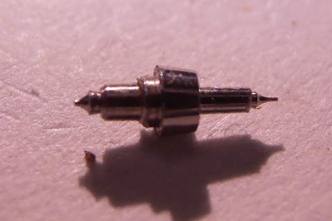

In a somewhat lengthy previous discussion
Staff replaceing

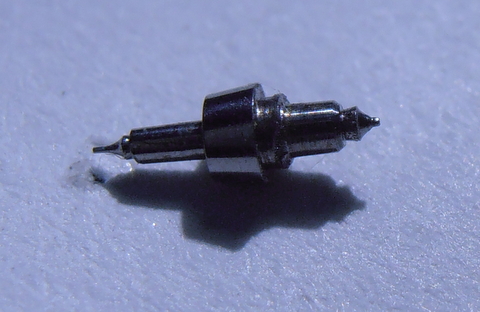

about the use of a #50 staff removal tool was questioned by some for damage to the balance wheel. I tried to explain how this staff remover worked without doing damage to the balance wheel, but to little or no avail.
Below is what is the result when I use a #50 on an Illinois 9th model Bunn special. The perfect rivet ring removed from the staff by the #50 remover is a little small for pierced ears unless you know a tiny fairy floating around somewhere.

Both Elgin and Waltham recognized the potential for harming the critical hole dimension and shape in the balance arm utilizing this tool. Your picture of the ring sheared off does NOT preclude what is left of the rivet tearing thru the hole on its way out the other side. I see this time and again where after a couple of staff replacements a new staff will no longer friction fit into the hole for riveting. I stand by my statement that just because a tool is made to do a job, doesn't mean the tool is a good tool OR that it does the job better than another method. By cutting the hub away from the opposite side of the rivet, all danger of damage to the hole is removed PROVIDING the person doing the cutting knows what they are doing. There are usually several methods to accomplishing a task and usually some methods are better than others. I respectfully submit that the tried and true method of cutting is the best and ONLY way to avoid the chance of distorting the hole...again providing the person doing it knows what they are doing and after all don't we want to preserve these parts for future generations? The number 50 staff removal tool will not help in this respect in my opinion.

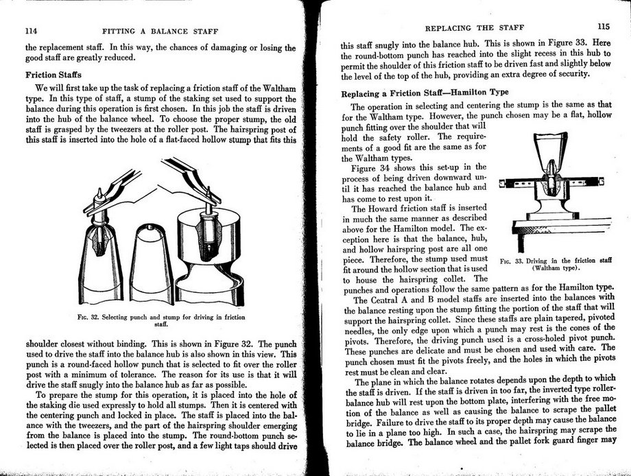

George, press fit staffs need to be carefully removed with the regular stumps and stakes available with most staking sets. The issue in removal is to make sure the balance wheel staff hub (an extra parts in most cases) is supported when the old staff is tapped out of that hub, otherwise you will knock out the staff and hub.
installing a press fit staff is explained by Fried:

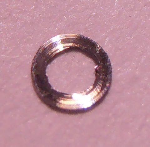

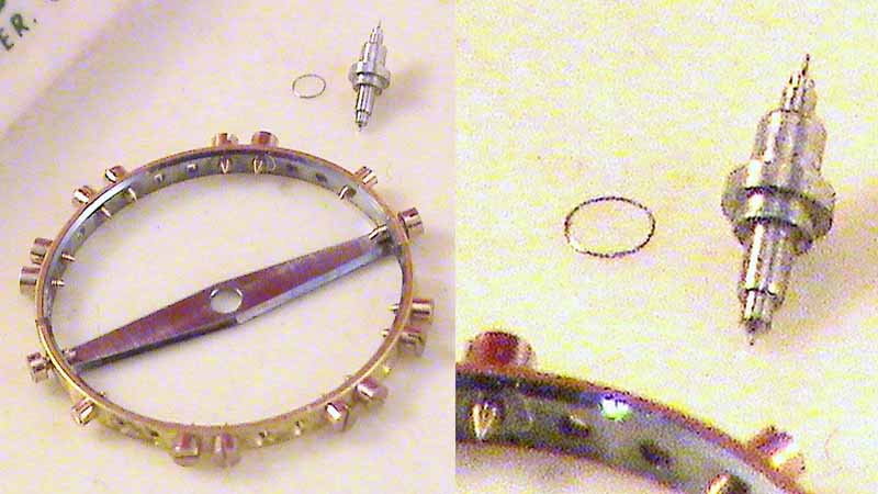

The rivet side is not cut, it is the hub side that is cut and then the staff pushed out the side the rivet is on so the rivet never comes thru the hole in the arm. Attached is a picture of the ring that is produced when the staff is cut from the hub side. Once enough material is cut away there is no resistance to simply pushing the staff out toward the rivet end.

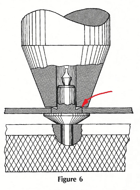

That part I get, Roger. The peened-over part of the rivet (red arrow) is what you're milling off in the lathe so the staff just pulls back through the balance arm.
Doesn't Dave's method shear off the same part, leaving that tiny hoop he showed in the picture? Or does that #50 thing do something else entirely?

No Eric...It is the opposite side that gets cut. See the picture in Patricks post that Waltham put out. The tool shears the folded over rivet and leaves the ring that Dave shows, but it also leaves the ragged edges tearing along the wall of the hole in the balance arm (IMO, Waltham's opinion and Elgin's opinion). Cutting from the other side, you are going in with the graver to a smaller diameter than where the staff comes thru the arm. You push the staff out with no ragged staff edges coming in contact with the wall portion of the hole.

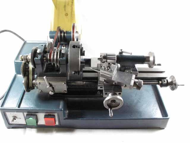

With a precision Jeweler's Lathe like the Cowell offered for $2999.00 on eBay right now, machining out the riveted staff would be easy. In the final round, I side with our top watchmaker who I quote: "When a watchmaker has a bad staff the best option is a new Balance wheel/Staff assembly from the manufacturer".

The Cowell lathe that Dave shows is not one I would ever use for watchmaking purposes. It may be very nice and well made, but certainly is not made for a watchmaker IMO. This looks like it would be great for a model maker. For those looking for a lathe, my personal opinion is an 8mm WW type which was made by Boley, Levin, and many others. Attachments/accessories for these are plentiful. While you may find a lathe for a few hundred dollars you won't be able to do much of anything with it unless you have a full set of collets and various other accessories. For a nice lathe with a decent assortment of collets and accessories you will probably have to spend at least $1500.

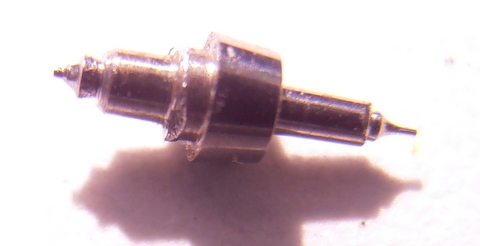

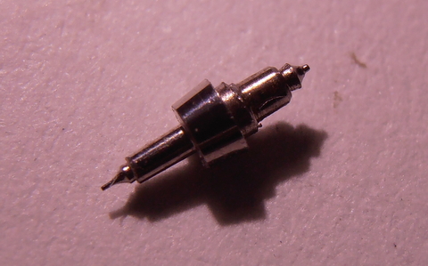

I almost hate to resurrect this, but I finally got around to taking an old junk wheel and removing the staff using the K&D no. 50 tool. The pictures speak for themselves. The ragged edge tearing thru the balance arm hole will damage the hole. I took a brand new staff after removal and placed the balance over it as if I were going to stake it. There was no friction fit over the staff. Just to be sure, I tried two other staffs and they all fit loosely over the hole in the balance arm. Since we are all interested in preserving these watches for posterity, I see no good reason to try to validate the use of this tool. It is destructive by its very nature.

Roger,I have replaced staffs both ways and must observe "tight" fitment of the balance wheel bore to the staff shoulder is "iffy" at best.
In all cases after a test fit, I carefully peen the staff bore with the correct radius tipped stake to assure a well centered, light press fit.

Roger J. Nolfe
Dave,
You make a very important point that in all cases a light press fit is necessary. Using the correct radius tipped stake is the only way to attempt to bring the hole back to a semblance of originality and I find that I have to do that as well many times when I have cut a staff and then found a loose fit of the replacement staff. I can also almost always predict when this is going to be necessary by observing that the balance has seen prior staff replacement. The evidence may be circumstantial, but I firmly believe that prior use of a staff removal tool such as the K&D no. 50 has caused the hole deformity. I would rather avoid this in the first place instead of having to try and repair the damage after the fact, which is really only a best effort at that point. I don't ever remember having an instance where it looked like I was replacing the staff in a particular balance for the first time, cutting the staff and then having an oversize hole in my balance arm. In the end, each of us must decide for ourselves which method to use and whether we possess the skills and tools necessary for our preference. I have a rather large investment in lathes and microscopes and have garnered the skills to use them so I can perform tasks in what I consider the best way possible. I can appreciate that others may not have that investment and if they want to replace a staff then the only method they can use is a tool like the K&D 50. This discussion sort of reminds me of someone with a nail in the tread of a tire. The quick fix is a plug inserted from the outside of the tire which is what many if not most facilities would do. The correct repair is patching the hole from the inside, but that of course is much more work and much more expensive.
