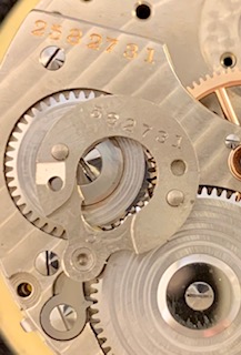

Dennis BaileyMy watchmaker just sent me pics of the parts of the watch that confirm that the numbers match the movement #2582731...here are two of them:

Dennis BaileySo...it's a genuine original factory made 992 movement with a 992E serial number

Tom DunnHi Dennis;
Basically, without that Elinvar marking, all you have is a 992. Numbers matching or no, it just won't qualify as a "narrowstripe" to buyers so unfortunately won't bring the 400-500 or more that the narrowstripes do. Or worse yet may raise additional questions as to the validity of the watch to a lot of buyers.
Did you buy the watch as a narrowstripe and pay more FOR it? If so, you may be able to send it back? Be my only guess...
