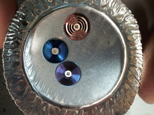

its easier than all of you think
all you need hot plate very clean hands buffed and polish no finger prints or any other residue on it
here is pic of what I do as you can see 3 different colors no problem with right temp. and you have purple hands.
Also there is a topic here on how to make hot plate
with chart of temp and the colors you get just search.
How you think my damascus dials get the colors from.

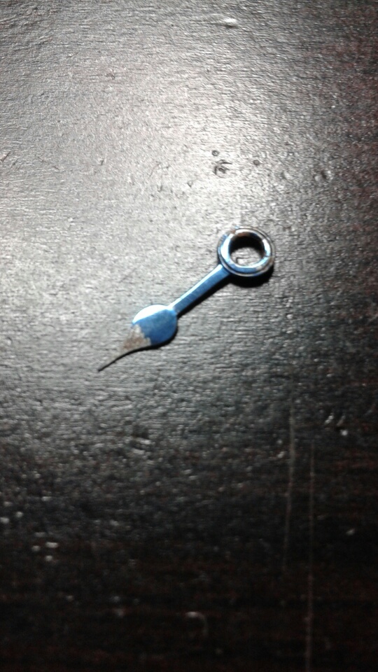

ok Im up for the challenge give me few days and perhaps purple hands will be made.
will post pictures of donor hands and perhaps done purple hands.
And if I made some purple hands please I will not be taking orders !
May 15, 2015, 14:07
Peter Kaszubski
picture of the volunteer I found in my hands box

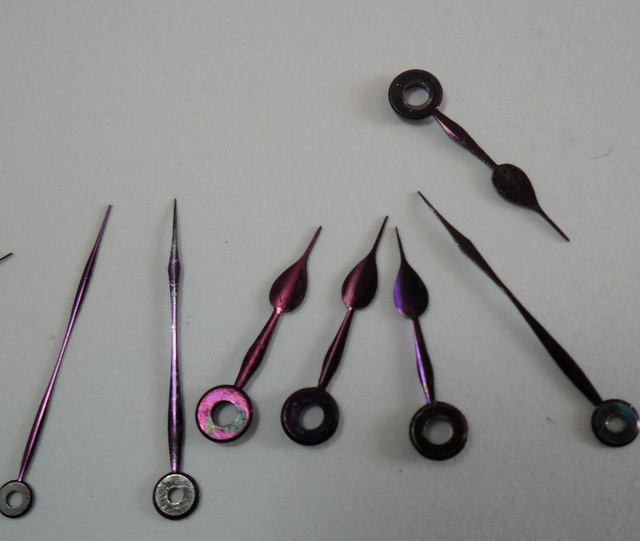

This is the best I can do.
May 16, 2015, 00:18
David E. Booth, Jr.
Lawrence - those are pretty good, for trying to do them by heat blueing - probably about as good as anyone can do. As you point out, purple is a very difficult color to control, and the slightest variation in surface, thickness, and even a minor dent or ding will adversely affect getting a true even color. All those reasons are why I am reasonably certain that when they were done in a factory setting, they were done chemically, in a temperature-controlled tank of blueing solution (commonly called "salts").
I don't have a lot of experience working with blueing watch and clock parts, but in the ten years I worked for Mr. Devilbiss, I learned a great deal about blueing firearm parts. I think the most difficult job we ha was matching the blueing of a couple of replacement screws we made for a pair of fine English dueling pistols in the Smithsonian collection. I remember Mr. Devilbiss wasn't fully satisfied with the final color we achieved, and wrote an apologetic letter to accompany them when we returned them to the museum.

I didn't do these, I just bought them that way or took them off of a movement. The hour hand all the way to the right is one of a set that I bought. Those colors were consistent to just that set. But it DOES show the different colors that you can get even trying to make ONE set. To me it's not about if I can BLUE/PURPLE them, but can I do it well enough to have then consistent enough to put on my watches.
Guess that's why I'll let someone with years of practice/experience do it the right way. Smile
