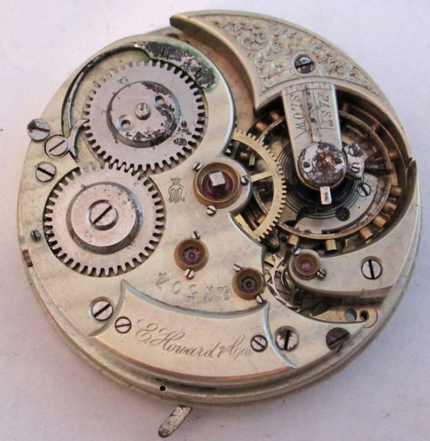

What is this E Howard
This looks like a fake to me but thought I would ask to be sure it wasnt something special. Serial number shows it is a series III which you can see it isnt. The movement is marked and spelled correctly. Any input??

Here is a post from a couple years ago for a watch Buster owns/owned, it has the same harp/lyre symbol as yours and the movement looks very similar but is marked with a different company name.

I believe this is a Gallet movement. I have seen several with the small name plate either blank, or with private jewelers names.

I forgot to add the trademarks are for pre 1900 Gallet products. The Lyre is a Gallet logo, though there may be other companies with a similar design.
