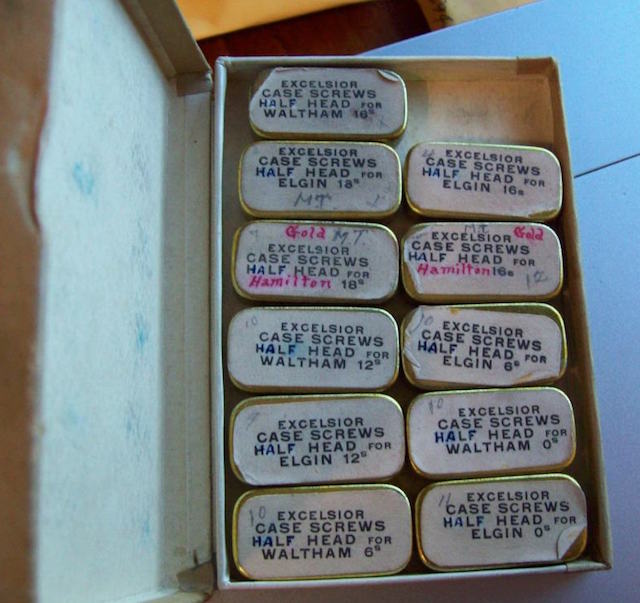

I do not totally agree with the line of thought that repair people made half head screws in all cases. I would concur that this would have happen at times but half head screws were supplied by some of the material houses.
I have tins of cases screws marked from some of the material houses that have their original labels that read half head screws. Maybe due to requests by repairers the suppliers decided to furnish the Industry with this type of screw, example below? I definitely agree that they are case destroyers.

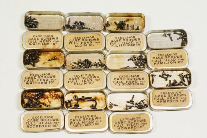

Lorne Wasylishen
Bila, looks like they catered to the needs of everyone.
My screws came in a box just like yours and I too need one tin to fill it up.
The orange stuff is grease not rust.
