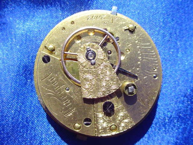

I have found a old pocket watch movement that I make out to be made by John Waddell of 88 Field St., Liverpool, probably a table roller 'scapement, made in the 1860s well thats my guess, not running looks complete any value on it

A few Waddells listed but non from Liverpool. One John active from 1866 until 1874. Listed from Southeastern England.. Could be the same.. These movements are nice to collect but will not ever be cased as they are most all one off, with the case made for the movement.. This one has a good set of hands and a usesable end stone. Chain is either off or broken..so ebay sells them from 12.00 to 40.00...more if they run... Hope that helps...

Sorry bad photograph, chain appears on and in tact just wound fully, do that make much difference

The problem, besides the diameter, is the type and placement of the hinge, and the location of the winding arbor.. The thickness of the dial and dial plate is also another "problem"when trying to shut the front bezel. In many years of fooling with this I have sucessfully "fitted" one movement to a case, and I think it was just luck. You can still tell it is a recase because most cases have the movement serial number in them...Just think if all American made watches had the movement number stamped in the case...
If it is wound up and not running, could be many things.... from broken staff to hardened oil....

Chris AbellThe staff also appears to be broken and also look as if someone has given it the one dip and a shake in a bath of oil!, when I get chance may take it apart and have a play are staff available for these?. Face Dia 37.6 mm hinge at 12, lock at 6, recess behind face is 36 mm, if anyone has a case for those sizes

Steve MaddoxOne of the significant reasons that watches of this sort have nominal value is because NO parts for them are available, neither staffs, cases, or anything else. If you can't make the necessary parts yourself, the chances of ever finding a replacement are essentially 0.
The "neatest" thing I've ever seen done with old movements of this sort is to bend a rudimentary "bow" from a piece of wire, place it through the hinge at the top of the movement, and hang them in a pocket watch dome for use as a desk clock. Aside from that, I've never seen any reasonable way of "using" one.
