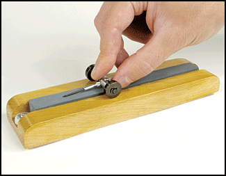

MICRO-MARK HAS THE "COMPLETE" SHARPENER KIT READY TO GO. THE SAME AS $150.00 SWISS RIGS, BUT THIS ONE IS $20.00.
Get your at;
http://www.micromark.com/screw...sharpener,10288.html

I got one just like it from E Bay, a few months ago for 12.00. The stone has a small chip in it on one corner like maybe it was dropped but I don't use the corners anyway.
Is an EXCELLENT unit after you learn to align the screwdriver blade so it is flat. I hold the stone up to eye level and then make sure the blade is laying flat on the stone surface. You can change the screwdriver blade to sharpen at any angle you wish and even remove chipped corners from the blade. I've been using 3 in 1 oil but think a good cutting oil would maybe be better.
You are right David, it is a great little in-expensive unit that really does work and is very well made also.

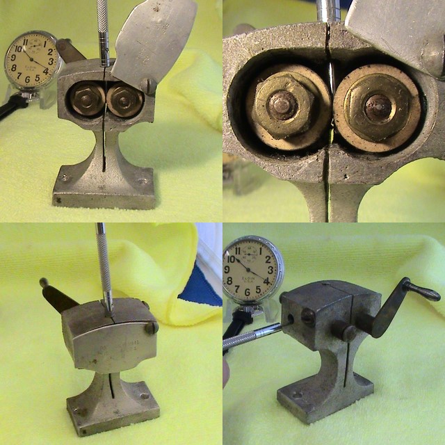

I am quiet interested in the way screwdrivers are sharpened these days, the tapered ends that you see on most new screwdrivers and also the style of sharpeners that are available in my opinion do not do a correct job (in my opinion). If you look closely as you use your screwdriver with this type of taper you will actually see it ride-up in the screw slot (the taper causes the torsional stress to push the driver upwards). If extra downwards pressure is not exerted a slip occurs thereby scratching the watch piece. The ideal way to sharpen them is to have the blade sharpened the same thickness, ending in a concaved curve at the shoulder. I have seen sharpeners that are like an upright pencil sharpener, these have two round stones and the screwdriver goes down in the center, turn the handle and presto, pefectly sharpened screwdrivers with the correct blade head.
I hope this is of interest to others and would like to know what other horologists think.
Best Regards to All,
Bila

Bila Wirriganwalters
Hi Edward,
Close to the same result as the pencil sharpener type radius at shoulder is a little bit heavy on the pencil type. When I talk to the brother again I will get him to email a couple of photos to show everyone the type of tool I am talking about. He has two, I have been trying for a while now to prise one from him, but no luck, probably holding on to it as the stones are hard to come by.
Bila

January 19, 2012, 16:09
Hi David,
This is the same as my brothers two, he also picked them up on Ebay,for a song . Thanks for posting the pictures.
BIla
