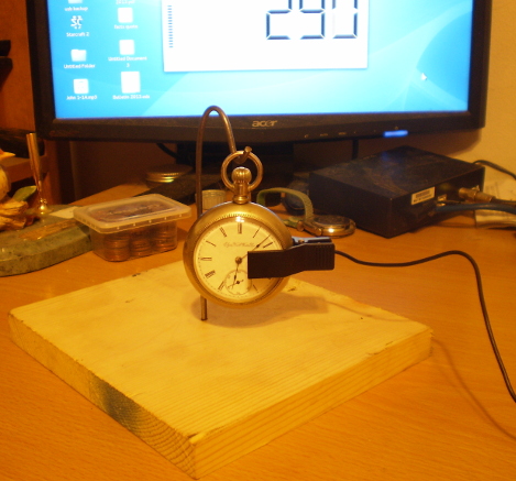

I drilled a hole in the middle of the wood block. made a hook to hang watches from the coat hanger and glued it into the hole in the wooden block. This is to help isolate the watch to avoid any false beats being counted from bumping the table the watch would sit on.
I clipped the microphone onto the watch.

Here is a photo of mine.

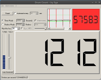

People having problems picking up the sound may want to raise the microphone volume in their sound settings. Also moving the microphone from one side to the other may help it pickup things better.

Unfortunately Dave the free software that I found doesnt check the beats for beat error. You can raise the volume of the microphone and watch beats, the read lines are what its picking up. I think Windows users (I use Linux) may be able to find other applications that would do a better job for them. The drum machine is written in python so it can run from sources on Linux and has a Windows exe.
