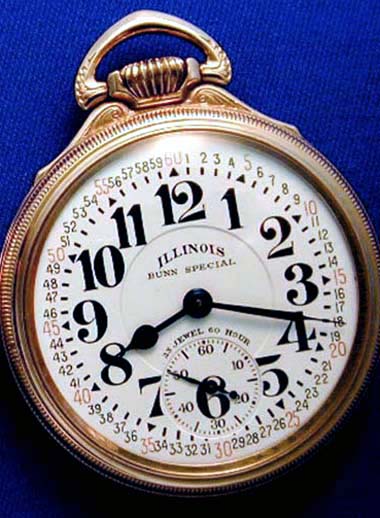

I think you'll find factory original metal dials were long gone by the time your friend's 163-A came was produced. Most collectors prefer one of the four styles of porcelain-enamel "variant dials" as follows...
Heavy Arabic with "Illinois Bunn Special / 23-Jewel, 60 Hour" above seconds bit.
Montgomery with "Illinois Bunn Special / 23-Jewel, 60 Hour" above seconds bit.
Heavy Arabic with "Illinois 23J Bunn Special / 60 Hour, 6 Positions" above seconds bit.
Montgomery with "Illinois 23J Bunn Special / 60 Hour, 6 Positions" above seconds bit.
The most desirable 163A variant dial is this one shown below...March 07, 2005, 22:05

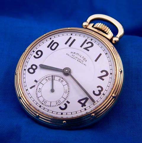

Now, about the 950B with the broken up melamine dial...
Melamine dials came in during the late 1940s and they are clearly shown in Hamilton's 1949 catalog. The serial number of your friend's 950B would help in establishing whether of not his watch should have porcelain-enamel or melamine composite dial. Correct original dials are around. Few are available and prices are climbing.
You asked... "Can it be replaced with a correct enamel dial?" ...of course it can. The next question is whether or not it would be appropriate. With values escalating we need to be more concerned with authenticity. I often quote Mike Chamelin... "We should collect non-argumentative examples"...meaning watches that conform to original factory information, advertisements and boxed sets such as the one we looked at above this posting.
950B number S17923 from 1953 melamine dial...March 07, 2005, 23:02

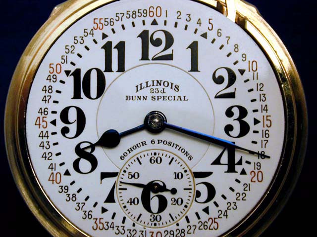

Jerry FreedmanI just told my friend that he needs a different dial for his watch. So now starts the hunt. I think I have seen some 163A's with bold dials that just say Illinois, without the Bunn Special, 23 jewel 60 hour data. Are they correct? By the way, the 163A is in a tu-tone model 28 case. Now, don't tell me that is incorrect also.
