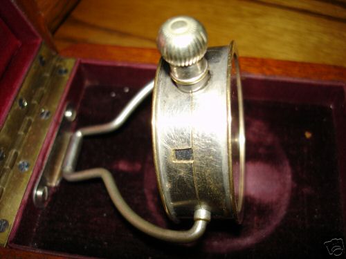

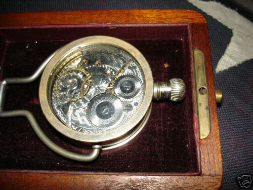

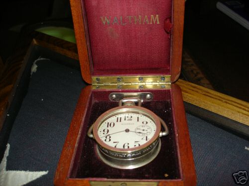

David AbbeThe watch case was easy to open and inspect the movement it held. Nice presentation piece too.
April 16, 2008, 02:28
David AbbeIf I were a Watch Mfr, Rep., this would be my choice of case
April 16, 2008, 07:42
Edward KitnerDavid,
A very nice set up.  First one I have seen that way.
I am going to be down by the NAWCC Museum this weekend.  If I have the opportunity I plan on a visit.  Hopefully I will get to see some eye candy!

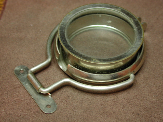

Jon HartingDavid,
Thank you! Now I know what this is that I found at a yard sale 2 or 3 years ago.
Jon
