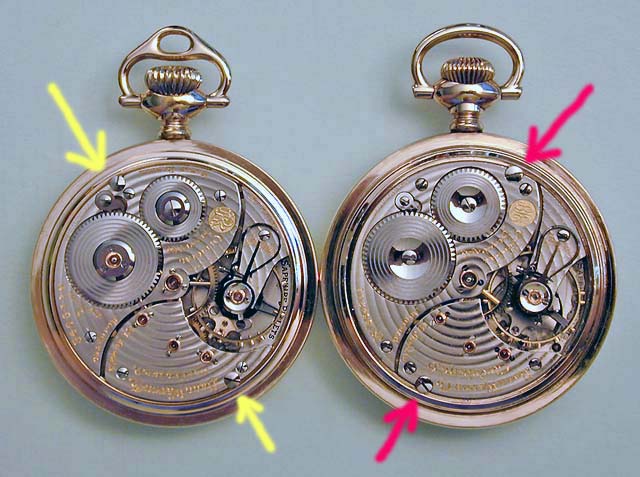

The watch under discussion is indeed a 16-size, 17 Jewel Ball-Waltham movement.
Sixteen-Size Ball-Walthams came in 17, 19 and 21-Jewel configurations, they all use the same dial configurations and the dials would interchange between them. I likely would have several Ball-Waltham to choose from but they may have minor damage.
Perhaps Jon Hart is confusing the a Ball-Waltham with Ball-Hamilton, that often happens. Here is a topic wherein we explain how to tell the difference...
CLICK FOR: Ball-Hamilton or Ball-Waltham 16-size Movement???
Hope this helps,
Ball-Hamilton on the left, Ball-Waltham on the right...

Jon Hart
Yep - The difference is between the the Hamilton and Waltham model...
Sorry for confusing the masses and myself (Ha! ha!)
And Yes - I have tried to put a Ball Hamilton Dial on a Ball Waltham to see if it would work. It is not too far off. Maybe just clip a dial foot off and put a dab of caulking at the missing foot location... (((( JUST KIDDING )))))

I have a ball waltham and noticed that the ball waltham uses the triangle hairspring stud while the hamilton doesn't. Bill
