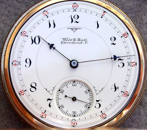

MOORHOUSE AND WEBB C. BALL, HELLO!Here's a really interesting
E. Howard Series VIII that has surfaced in California. It is in the hands of our own Cheryl Ohland who is "lablover49" on eBay. Her interest at this point is in finding out everything she can about the watch, especially the dial. Although I am no expert on these dials, I believe I am seeing definite
Moorhouse characteristics here.
Going a bit further I can tell you this dial would have been originally sold on a watch retailed by Webb C. Ball Jewelers which was at that time located on Superior Road in Cleveland, Ohio making it essentially a "Private Label" dial. Do not confuse the retail jewelry store with the Ball Watch Company as that was a separate entity. But be that as it may, whenever a dial like this surfaces the combination of
Moorhouse and
Webb C. Ball, Cleveland, O. sets my pulse pounding.
The case is engine-turned with a plain cartouche and marked "E. H. & Co." Case# 37223 and of course 14K as expected on high-end Howard Cases. Owner's inscription on the cuvette is
Lyndon V. Grover - 1897 - Lynn, Mass. Is this a beauty or what?

Phil DellingerLindell,
I agree with you about this being a dial with the typical characteristics of Moorhouse dial.
In the section of "Pocket Watch Discussions" locate the topic: MOORHOUSE DIALS .....School Is In Session.
I'll bet Harold Visser will jump in here soon with his very expert knowledge.
Indeed these are very desirable dials, especially if they are signed By J Moorhouse on the reverse.
My dial is attached to an 18S Hampden. Here is the dial that I posted to that topic.
Phil Dellinger

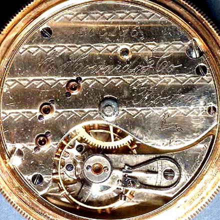

Harold VisserYES, that is a Josiah Moorhouse dial!!
This watch,#305196 doesn't show up as anything out of the ordinary in the factory records, finished 11/1/1890 and transferred to their Chicago office two months later. This certainly is a very unusual combination though not unique. It certainly would fit right in with my other Howards!!!

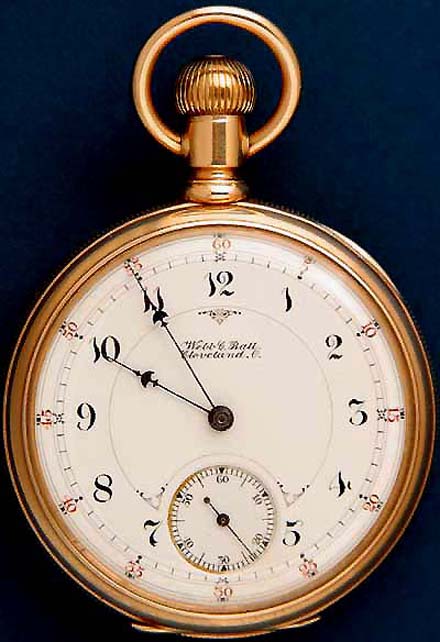

Dr. Clint GellerI have seen three Ball Howard Moorhouse dials in my travels. A signed example with unique calligraphy, that I used to own, is pictured in my August 1993 BULLETIN article. Another I saw in the collection of the late Mr. Don King, although I don't know if it was signed on the reverse. I have also heard an unconfirmed report of yet another example. In my August 1993 article, I also showed a Ball Hampden dial essentially identical to the one shown on this thread. I speculated then that Moorhouse may for a time have freelanced for Hampden after his departure from Howard some time after 1894, but I tend not to believe that any longer. I now think that the Ball Hampden dials in the Moorhouse style were conscious, "unauthorized" copies of Moorhouse. (Moorhouse's style wasn't copywritten, so there was no way really to prevent this.) Furthermore, Howard Moorhouse dials have a certain delicateness of feature that seems to be absent in the Hampden copies.
Clint Geller

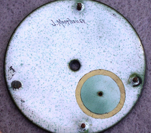

Harold VisserHello everyone, thought maybe a closer look at the dial would be appreciated, and yes it is signed J. Moorhouse on backside! Comparing the "Webb C. Ball Cleveland, O." logo to Phil's Hampden Moorhouse dial logo,it seems to be almost completely identical in style and form.
Harold

Harold VisserHere's the backside of the dial, the signature is baked into the enamel. Harold

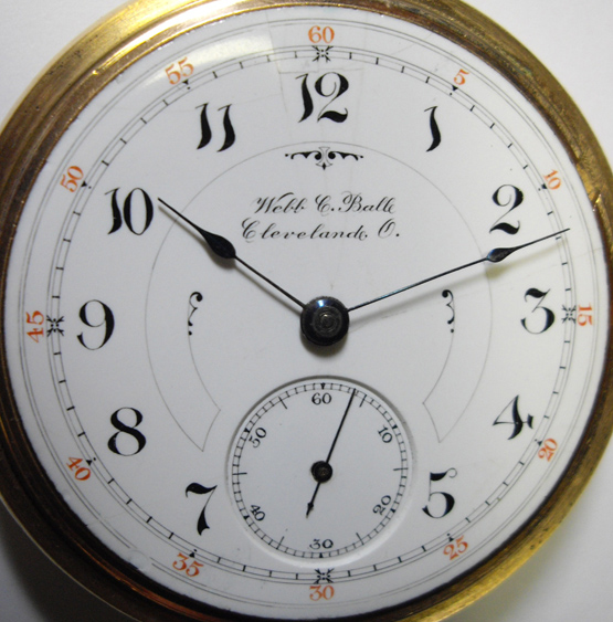

Ken HabeebI'm resurrecting this old thread to say that upon closer inspection of the E. Howard dials versus the Ball-Hampden, the numbers and flourishes do look a bit different, meaningful or not. Also the signage, or lack thereof between those timepieces, is interesting.
kh

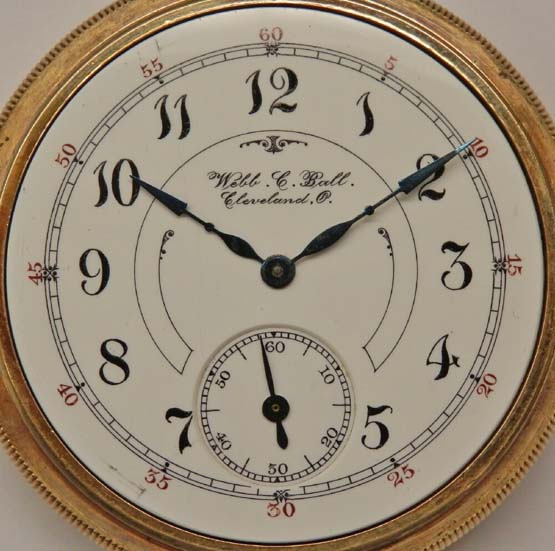

Here is an unsigned 18s Ball-Hampden dial for comparison.
JBS

John ScottI found the dial loose. I have applied it to 23J Special Railway 1150060, a beautiful tu-tone movement but not a Ball-Hampden movement, of course. I do not own a Ball-Hampden movement. My basis for this disposition is that the dial is the same as that shown by George Townsend in Plate 170 of his book American Railroad Watches. It is noted, there, that the dial in Plate 170 is from the personal watch No. 1201174 of J C Dueber. When I enquired of Col Townsend as to the kind of movement that it was, he wrote back and advised me that it was a 23j Special Railway. I have his letter, dated 19 September 1981.
