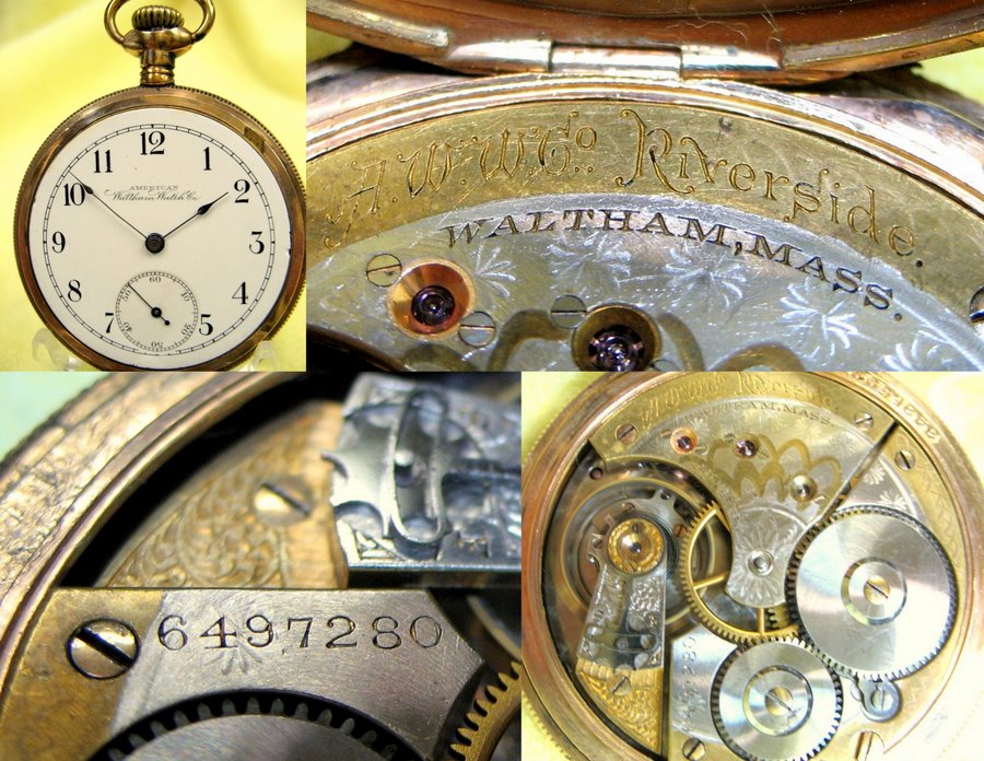

Theodore, this marked "non magnetic" model 88 with double roller design is one of the sweetest (and I think Rarest) in my "88's".
Think of it, made in 1894 with double roller, true motor barrel, and a non-magnetic hiarspring.
I believe that the Models 1888 and 1892 finished and put into production under the tutelage and direction of then W.W.Co. President Royal E Robbins, put W.W.Co. at their technical pinnacle. At this point in time they were decades ahead of the rest of the worlds watchmakers.

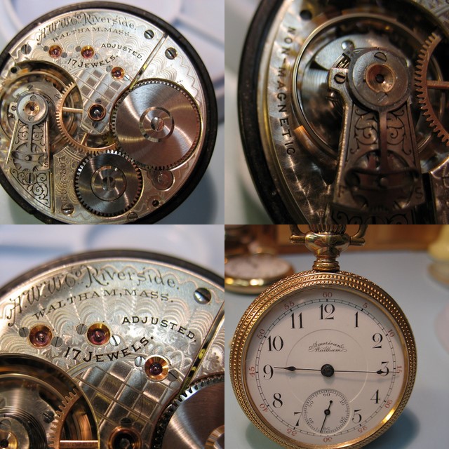

Talk about 2-tone damaskeening "Art of Watchmaking"! These model 88s are beauties! I am just trying to add stimulus to your case search.

Thanks for showing those beautiful 88's. Dave..,I really like that Riverside.Yours has a better style regulator, mine has that earlier style.Mine 1s also a 6 million S.N., so I think it should also be double roller.After 6 mil., the higher grades are supposed to be D.R. I'm checking into a nice Fahys YGF/O.F. case with a 7J '88 in it.Thanks again!...Ted.
