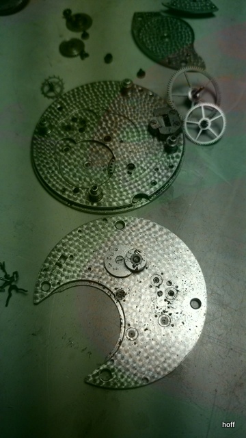

Kevin HoffmanThis is a timely topic ,I will be interested in hearing everyone's strategy . A few weeks ago I sent an Illinois out for a crystal,along with some others for service , I was not going to service this one ,but went ahead anyway ,the dust ring was in place on this one too ! For a cased and working watch it is the dirtiest I have seen . edit , most of my watches get cleaned & oiled , if they run really nice I don't ,unless I am going to carry them .

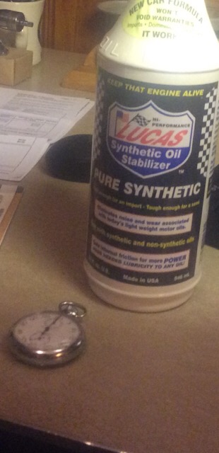

Mike BendaWhen the prez says keep going...
I use this on 8 day clock springs.
Scrub with wd40, then wipe with synthetic.
Works so far, but these are all personal clocks,I do not profess to be a professional.
Mike
