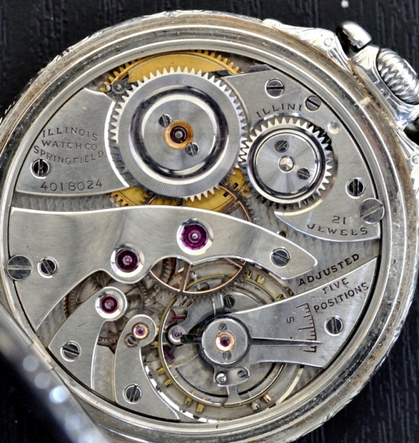

Below is a picture of a movement from a 12 size (Grade 528) 21j Illini--most 21j Illini were 13 size.The 12 size are relatively scarce.
How can you identify a 12 size Illini as compared to a 13 size one if you don't have a ruler or serial number table..
I might add a picked up two 12 size Illini cheap because I knew the difference .
Bob

gold train

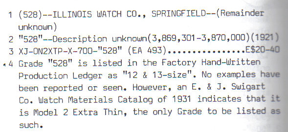

Bob,
The Megger's book says that no 528's have been seen. Yours is a 538 as it is 21 jewels and a 13 size whereas the 12 size was a 23 jewel. If you want, I can scan the pages referring to these and email them to you. Your watch originally sold for $204.00 in 1923. You could have bought a 23 jewel Sangamo for about $60.00.
Steve

the watch pictured is a 12, 528. Most probably wound up in Hamilton's grade 400 but not all.

Steve Middlesworth
The book says "538" was the grade for 13 size but "Illini" was the grade for 12 size. This has the friction-set jewels in the center, third, and fourth wheel which was consistant with the "Illini" grade. The book also says the "Illini" grade was only available in 23 jewels. So have we found more errors in the book? I know I have come across several so it might just be.
Steve

Steve Middlesworth
After doing a search of the site I found several other references to the 528 Illini. I have penciled in the correction to my book.
Steve

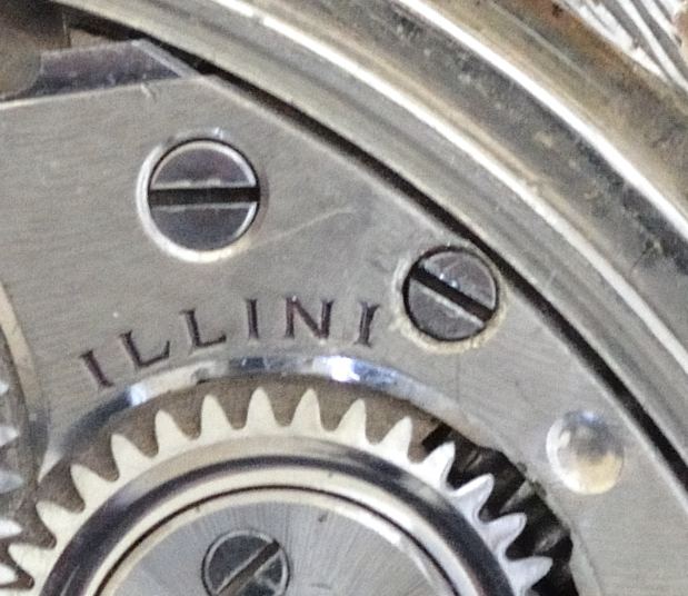

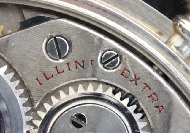

I have found that there are two ways to differentate the 12 and 13 size 21 jewel Illini.
Method One-movement
Look at the screw next to the i in Illini.
If the screw is at the very edge of the movement it is 12 size. If it is slighlty further away it is 13 size
Below is a 12 size movement

Here is the 13 size movement

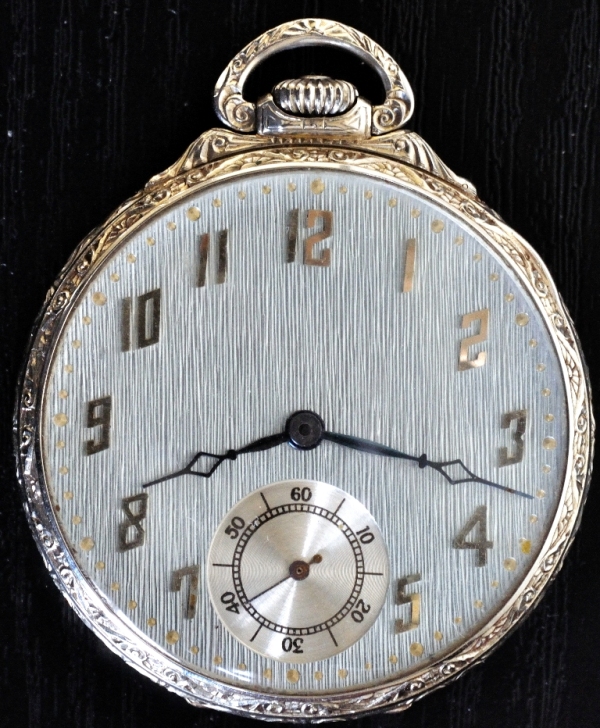

METHOD TWO
While not a 100% guide many of the 12 size Illini come in a relatively unique case.I have seen one or two Marquis Autocrats in a similar case.So far if it is an Illini movement I have only seen the 12 size version in this case.
I might add I got the watch in my picture for $125 on Ebay because the buyer could not open the case. I took a gamble that it was a 528 in a 14kt case and won.
Bob
