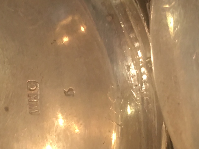

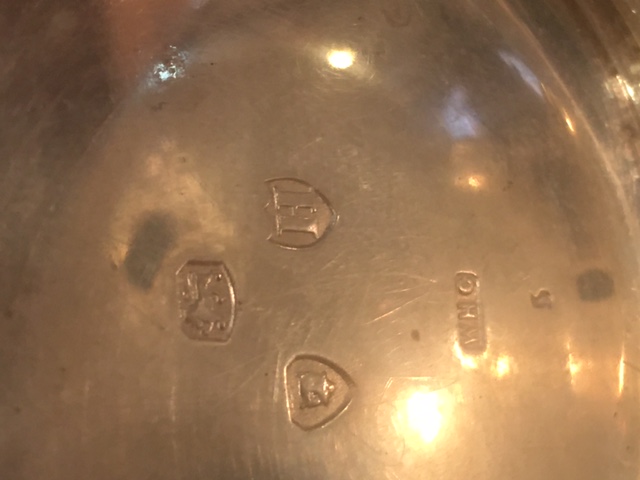

I have a Geo Oram & Son watch S/N 16981, in a silver case.
I am looking for information on the movement and also on the case.
From the marking on the case I think it is .925 silver made in London (CTAS face), around 1826 (BOLD H in a Shield), W H C in a rectangle.

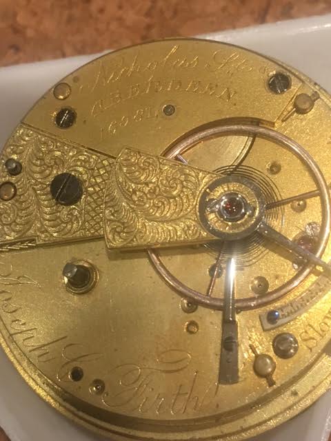

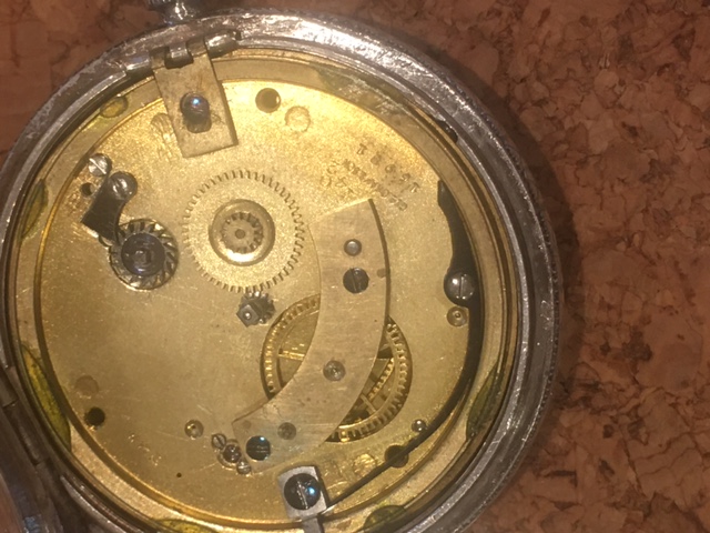

John WillisHi Melvin: Nice watch. I think it may be considerably later. I think the date stamp is more likley to be 1883. Also the british Museum shows Geo Oram & son to be active in 1842 -1875 ( your watch may have been finished later.) If you could show the other plate and a view of the movement side it would help. I think a watch from 1820-30's would be much thicker. I am thinking your watch would have had gold hands when new.

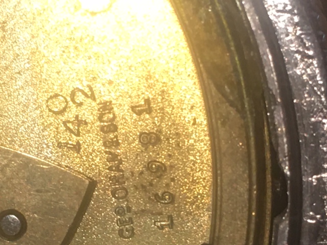

Melvin SiedmanPS any idea what the jumble “1402” means?

John WillisHi Melvin: I understand you reluctence to go further. It is easy to get in trouble with these watches.First: Lion stamp indicates it is silver.
The trangle shaped stamp with what appears to be a pussycat with a mustach is the mark for London assay office.
The date code is determined by the shield shaped mark inside the back of the case. Yours has the letter H in it. If you compare it to a chart of "London Date Letter marks" you will see it is 1883.
The arbour and ratchet wheel you see under the dial is NOT to wind the mainspring but is to set the tension on the chain (yes chain..like a minature bicycle chain) that runs from the mainspring barrel to the fusee. It should not be moved unless setting up the tension of the chain. It is the arbour on the fusee that is wound to wind the mainspring. In order to do this the movement has to be tipped out of the case. IF you look at the dial side of the watch with the bezel removed you will see (by the pendant a tiny hinge) opposite it (@ 6 marker) you will see a tiny catch. Using a thumb nail to press it you will find the movement can be lifted up to allow you to see the "top plate" this is the one I was refering to in my earlier message). Once opened you will see the balance wheel and cock. You will also see the winding arbour that winds the fusee which in turns pulls the chain that winds the mainspring barrell that winds the spring.
It is a rather complicated way of doing things but there is a reason which I will not get into here.
So you will not have to remove the dial to wind the watch but simply tip the movement out of the case, take the watch key, put it on the arbour and wind away (caution.... I would not wind it fully but only 1-2 turns to assess how it runs, if at all. I do not know what 1402 means, John

I did a google search for Joseph Firth and found a little info.
Apparently he was noted as a Watchmaker, Jeweller, Optician at 29 Nicholus St Aberdeen.
He had an ad In the Aberdeen Journal in 1877.'

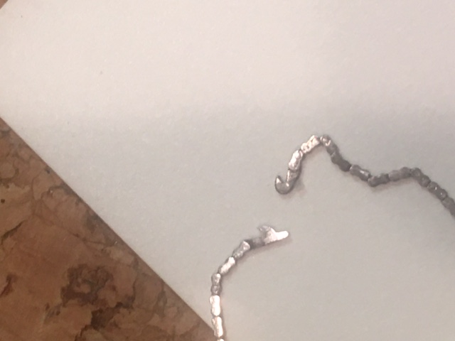

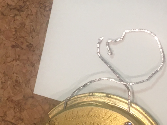

Also a note re. him that he was perhaps a retailer but not a watch maker. Your watch would seem to confirm that ie. ebauch by Geo. Oram & son but jewellers name of Joseph Firth OR an early example of a Jewellers Dial watch. I don't know as I have seen another fusee watch with a Jewellers dial. Looks like the chain might be ok, only undone. Tricky job reattaching but I an sure you are up to it.john

Melvin SiedmanHi John,
I am not familiar with this mechanism per se.
It looks, to me, that to wind the mainspring, you actually turn the fusee arbor and the fusee chain pulls the mainspring barrel to wind the mainspring. Does that sound right. The click for the mainspring is on the fusee arbor, not the mainspring barrel.
And somehow on my watch the click has come off the teeth, allowing me to just turn the fusee barrel.
Referring to the attached pic, if I loosen these two screws and remove this plate what should I see.
The fusee arbor and part of the mainspring barrel?
Do you think with that plate off, I will be able to reassemble the chain? Or will I have to disassemble it further?

HI melvin. What you are describing is basically how it works.
Referring to the picture with the red lines on it:
The arbour you see here is for the fusee and is used to wind the watch.
The two screws circled hold the barrel bridge on. If you take them out you can remove the mainspring barrel and therefor check, clean the mainspring. I see the chain is off so the mainspring will be let down. You should be able to reattach the chain but it is not easy, you have to determine which end of the chain goes to the fusee and to the mainspring. If the chain is still in the watch ie behind the fusee it shoud be self evidant. You have to attach the hooks to the little slots in the fusse and barrell and then wind the chain outo the barrell and then onto the fusee therfore when you wind the fusee it pulls the chain onto itself and off the barrel while winding the mainspring. The arbour on the back plate (on the barrel) is used to tighten the chain so when the watch is run down the chain will not fall off. The tricky part of this is to wind the chain onto the barrel and maintain tension preventing it from falling off. I have done this by putting both hooks in place then holding watch vertically, put a very small wt. on the chain to provide tension.(think of closeline with wt. attached to middle) Then wind chain unto barrel. When partially wound up turn arbour on barrel 1/4-1/2 turn to provide tension when wound down. Its been a long time since I have done this so I hope you can make some sense of all this. It took me quite a few tries before I got the first one in!!!
You might find by removing the balance cock and balance with HS it would be easier.
Hopefully This helps. John

Melvin SiedmanGetting the chain back on both the cone and the mainspring barrel proved to be a difficult undertaking. There were three basic elements,(1) getting the chain snaked thru the post and facing in the correct direction, (2) hooking the chain on the cone, and (3) hooking the other end of the chain on the mainspring barrel. I was good at all three, but NOT at the same time!!!. I could get the chain snaked thru in the proper direction and hook one end, then when I went to hook the other end, one of the other requirements became UNDONE. Persistence and getting up from the bench more than once, finally paid off. Using John Willis's suggestion I finally got all three elements successfully done.
The watch is running under its own power, not perfectly, but running.
Now that I have some semblance of how a fusee works, I will take it apart further, clean , oil and hopefully put it back together.

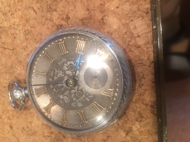

As you pointed out the hands are probably not original. The movement is in a silver case, so gilt hands may not have been the proper match.
The second hand is totally missing, and the minute hand has a square that is larger than the mating post.
My search starts now. I have plenty of hands , but most for wrist watches, Bulova's, ETA's and AS movements.

John WillisHi Melvin: Would I be correct in thinking the dial numbers and dots are yellow gold? I have had some watches like that with sold gold numbers, dots and hands. ie hands were solid gold not plated. The dial itself would be silver. I don't think I have any but will look. What is the dial diameter of the dial. John
